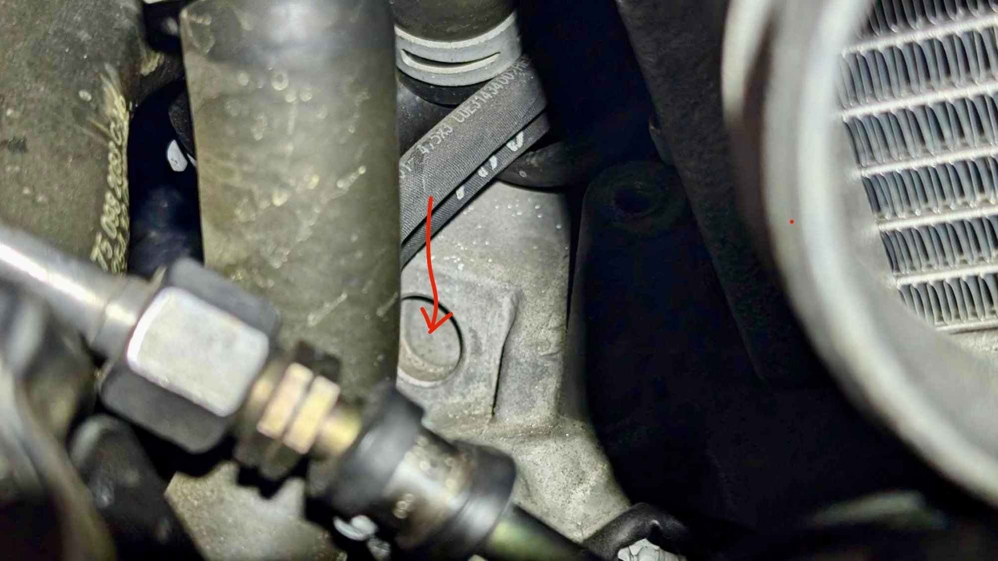

Hello, on my m275 engine (2007 sl65) the left bank camshaft position sensor is missing in a place where it's supposed to be based on WIS (on a valve cover behind intercooler). Interesting that the right bank has a sensor but not left one. I guess my modification of m275 has the sensor in a different place or doesn't have it at all... Does anyone know where left bank camshaft position sensor can be on my engine ?
No camshaft sensor on left bank, the right bank has a sensor in the same position.

There is this picture online where it should be (B6/2) but I don't have it there on my M275... http://benz.ehost.tj/221/webetm/webe...rces/B6_2.html

I have m275 2008 s600 w221 and I have the same thing, only one sensor on passenger side, want to find out if it only has one or i just can't find the second one

I think it has only one but I have not seen a prove of it only the fact that I looked at the valve cover everywhere and have not seen it. Also in the diagnostic tools it shows only the right bank sensor data.

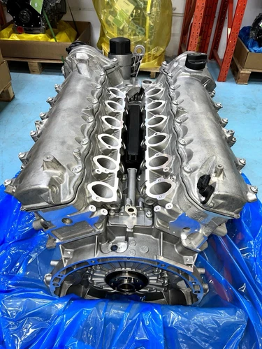

Rebuilt 07-13 Mercedes W221 S65 AMG V12 6.0L M275 Complete Engine Motor Block - Picture 2 of 6
Better picture showing there is no sensor on the left bank. Engine: 275.982

No variable valve timing so no need to monitor where both cams are.
