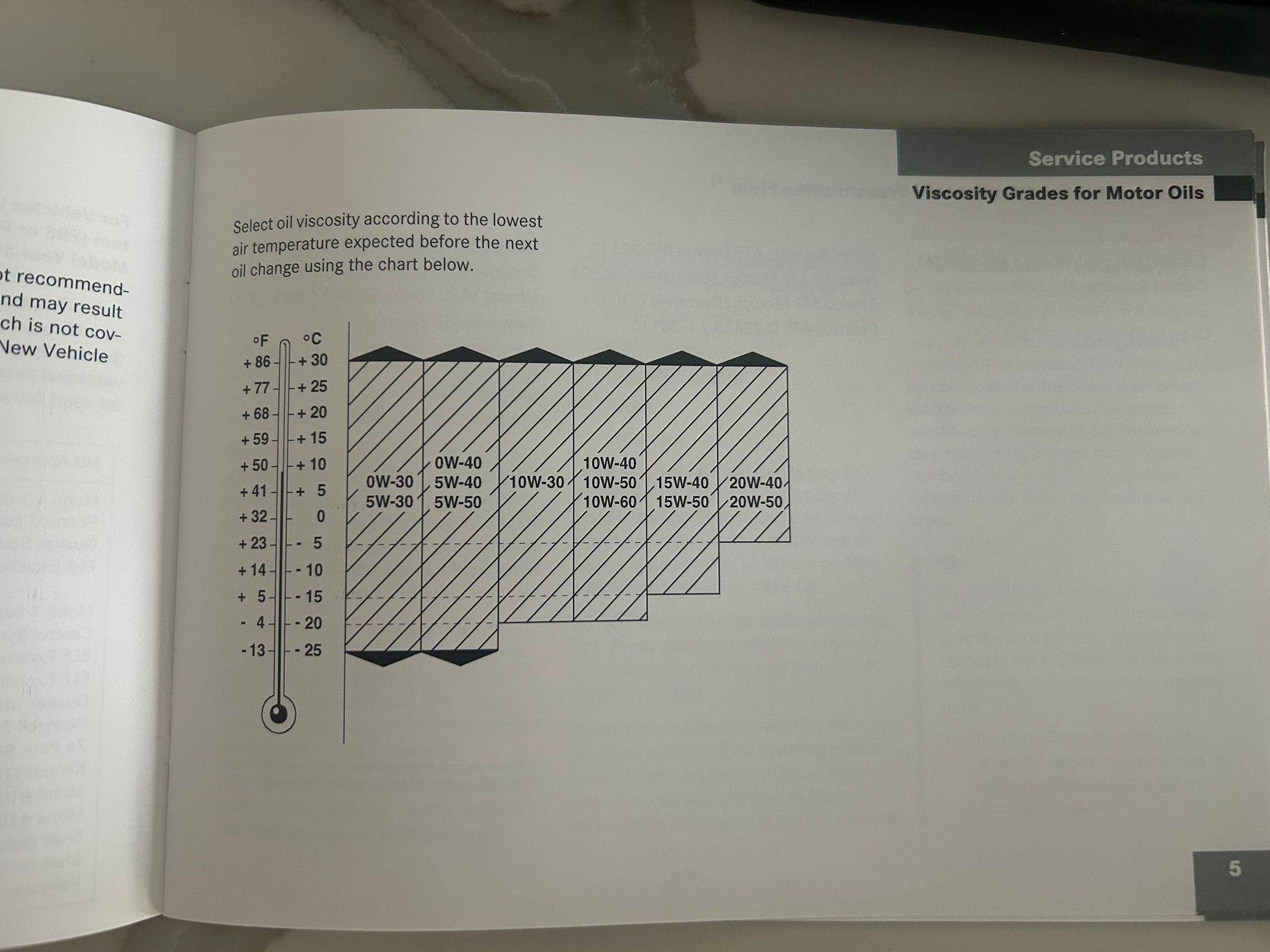

Preferred viscosity for M275?
I did some searching but didn’t find much discussion (I may be doing it wrong…) The maintenance book shows quite a range of acceptable viscosities… from 0W30 to 20W50. Plus from what I can tell this maintenance book is not M275 specific. I initially planned to run a 10W40 but might go thicker since it rarely gets under freezing where the car spends most of its time (FL).
just wondering if anyone has done used oil
analyses on what they are running, and at what intervals & usage. I plan to but it should be a while before I put enough miles on new oil to draw any conclusions.
edit #2: per this link, it looks like only 0W30 to 5W40 are 229.5?

Appreciate that, and am planning on running 5W40 full synth. Odds are any API SP would be 'fine' but I did some more research and it seems a big part of the 229.5 spec is HTHS values and not all 5W40's make the cut...
BUT, M1 and Pennzoil Platinum Euro do and are readily available locally, already have a Mann filter kit for it, so will just go with that, and keep to 3-5k intervals, with perhaps a UOA since its an inexpensive way to monitor the wear. I was just weirded out by the breadth of visocsity in that non-model specific maintenance book.
Look here: https://operatingfluids.mercedes-benz.com/sheet/223.2
229.5 Note 2 and Note 5
Note 2: Use only 0W-40 or 5W-40
Note 5: Recommended 0W-40
Some times ago in older variants there was a note AMG 0W-40 only, i guess.
