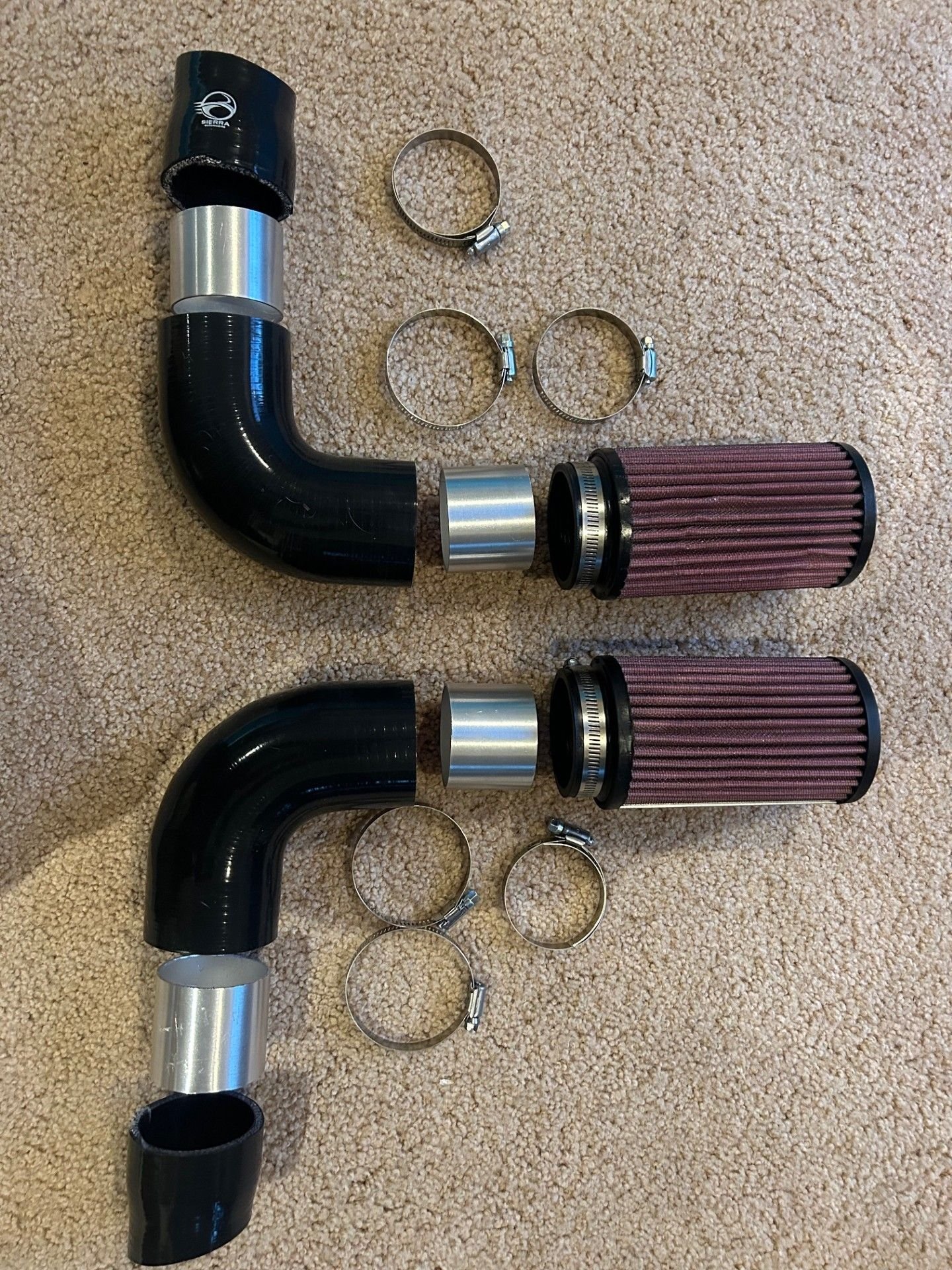

My custom air filter setup consists of these parts. Tubing and filters are 2.5" with a reducer to the 2.25" at the turbo inlets.

Performance run a few days ago showed a max torque of 583.3 lb/ft and a max intake pressure of 30.2 PSI, subtracting ambient 14.0 pressure gives 16.2 PSI of boost.

Obviously this is not an absolutely scientific test, but it supports the general belief that the stock air filters reduce performance. Since the before and after stock air filter runs were within 0.5% of each other, I think my methodology is reasonable.
Let me say that I could immediately feel the difference without the air filters. It felt like a different car, much bigger improvement than adding a tune.
The filter-less setup improved torque by 12.7%. My simple air filters improved torque by 5.5%.
