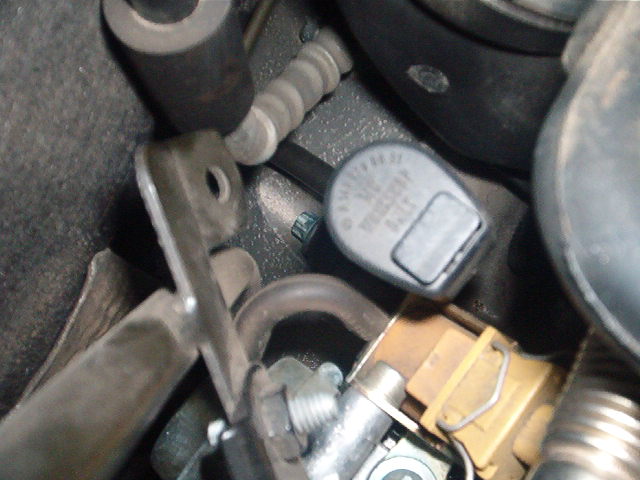

Is This the Tube on a C320?
I'm assuming the cover to the transmission fluid level inspection port/tube is in the center of this picture.....correct? How does the cap come off? There seems to be some kind of tab on top of the cap - do you put a screwdriver flat head in the tab and pry up? I want to put a tube down to the fluid to extract some for analysis and see how "lifetime" it is.

Buy a replacement tab first.
Thanks for the heads up! So it's the rectangular tab that breaks off and you just pry it up? Also, is this the normal fill point?

Snap off the tab and poke the remaining part through with a thin blade screwdriver, then pull off the cap. There is no dipstick in there, but you can buy one from your dealer to check the level. They can also sell you replacement locking tabs to go back on afterwards. Supposedly these transmissions are 'lifetime' for fluid, but following experience with BMW I will be changing my C32 fluid @ 50,000 mile intervals.
