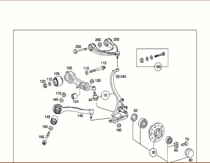

Like MBTECH2003 mentioned, you may have to replace the steering knuckles due to the different spindle sizes. A guy on the W211 forum did a similar brake upgrade and had to do this. Here's a picture of a steering knuckle on a W211 model look at item #10 (which includes the ball joint).

Apparently I do need to replace them. Does anyone know of a source where I can get MB parts, preferablly cheaper than MSRP.

One can either remove the stock ones and redrill them to the correct Dia as the AMG Brake calipers use a LARGER Dia Shoulder on the caliper mounting bolt. The Machune shop should have a vertical mill or a high end drill press..as you dont want to be off on the drilling..Or Just Install New replacement spindles...
I Installed the AMG brakes on my wifes W211 and it was a bolt on upgrade
