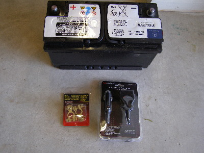

You’ll need the following items:
A) Schumacher SEC-12V-OBD Cable (~$15 at AutoZone)
B) 12volt Power Source (I borrowed an old battery from my local MB dealer)

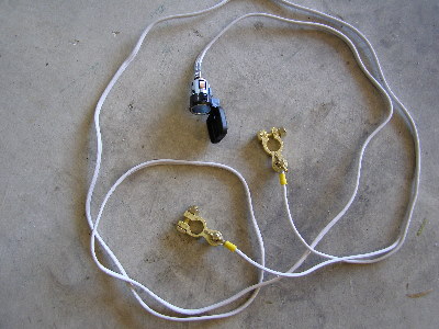

C) Homemade cable – battery lugs to female 12v cigarette connector
For the cable, I used an old household extension cord. Remember, we are not trying to start the car; just maintain a keep-alive voltage to it. I soldered the lugs onto the cable to eliminate any chance of electrical noise.

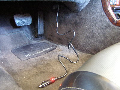

Step 2 – Connect the Schumacher cable to the OBDII connector under the dash. Look for the red LED on the cable to light up. This confirms that the circuitry will accept an external 12v signal.

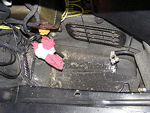

Step 5 – Remove the ground lug from the main battery in the trunk. At this point, the main battery is electrically disconnected. If you have done everything correctly, the red LED on the OBDII cable should still be lit.
Warning and Caution – You are about to disconnect the positive lug off the main battery and there is still 12volts running throughout your car. Therefore, the positive lug being disconnected is still live with 12volts from the external battery. As a precaution, I wrapped my wrench with duct tape to ensure that if it slipped, it would not short out the 12volt power.
Step 6 – Remove the positive lug from the main battery in the trunk. Once the positive lug is off the battery immediately wrap the metallic end with a dry shop rag. This prevents the lug from coming in contact with ground.
Step 7 - Remove your battery and do whatever you need to.
