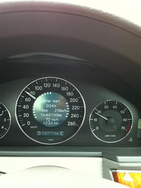

Hi
I have a 2005 E200 W211 and have below questions
1. The attached pictures of the cluster lighting shows intermitten illumination.
This is visible even before the car is ignited and will continue flashing intermittenly few times every minute
2. When cruise control is set (in this instance set at 80kmh), the remaining cluster lighting (from 80kmh to 260kmh) is lighted
After cruising for about a few minutes, the lights go off
Any bros encountered the above?
Is this normal? if not is there a way to resolve this problem?
thanks in advance
Attached Thumbnails Instrumentation cluster flashing - anyone encountered?-img_2789.jpg   Instrumentation cluster flashing - anyone encountered?-img_2788.jpg

Answer
My best guess is a bad instrument cluster ground, and/or circuit board issue.

Any chances of repair? I was told by the workshops to change the whole cluster that cost few thousand dollars

Any luck fixing this , I have the same problem on a 2000 clk

mercedes had a recall on some older models which extended the warranty on the instrument cluster to 10 years which ran out in sept. 2013. check with your dealer and mbusa to see if there is a recall, or they can help financially with the repairs.
