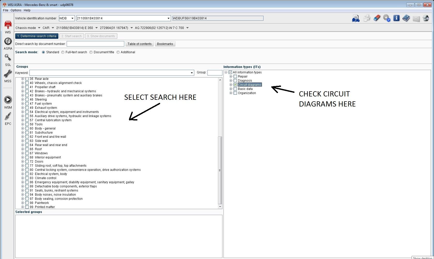

Having a tough time getting to what I really need. How would I navigate to a wiring diagram of a headlight, ie the pins on the connector and what their role is, ground, drl, etc ? Can someone help ?

Well for starters if you have access to it, I would use STARwiring. If you don't and can only use WIS, you need to use the check box on the right side that says "diagrams" once you have selected what you are looking for in the left box.

Thanks I found the diagram, but how about a picture of the connector that shows what each pin is ?
