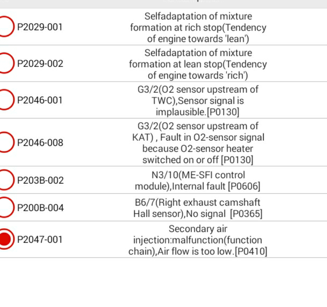

Fault code are all around since ac compressor and auto transmission fluid change
Looking for help guys car is down from 3 months ..any help will be great ....<br/>To start its a w211 e 200 kompressor 2005 1.8 done about 65000 miles ....<br/>The transmission hose was out car machinic added oil in engine.instead of transmission drained and etc ..finally almost rectified the ac compressor gave up ..installed ac compressor car started heating ..fan will start only if ac is on and at very high speed ...ac is give only cold air no warm ..changed water line and sensor car is now not heat ...but shuts off after 30 to 40 minute.

get the fault history cleared and run the car. see if they come back. these could be faults from before the fluid changes.

Hay thanks buddy I did that other day codes were clear but again when I drove the vehicle about 20 km it shut down completely......disconnected battery wire and then it started back

But when it had stopped I checked battery truck it shows 13v....dynamo test I did perform 14.1v ....but auxiliary battery was at 9.3 v ...
