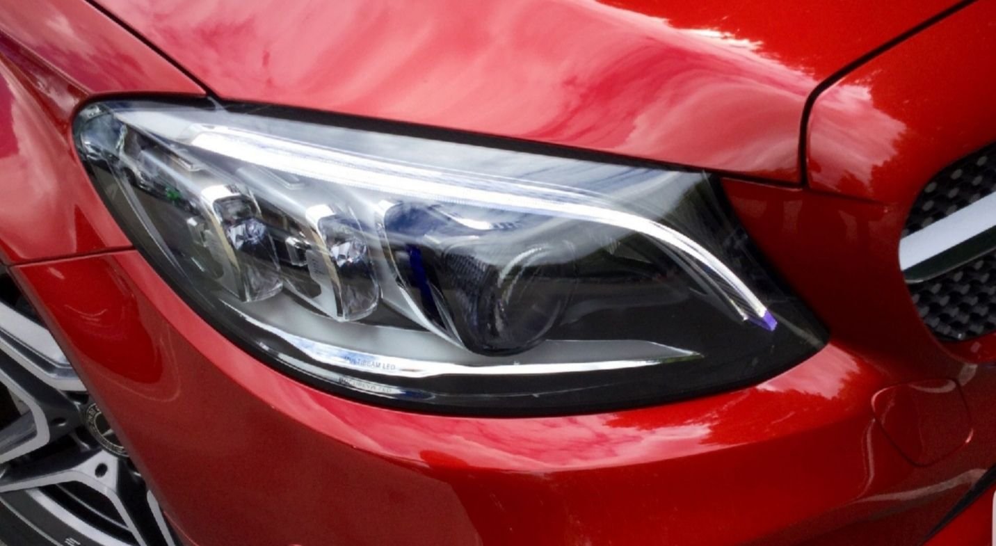

Hey guys,
I've got a 64 reg Mercedes C220D Estate which I've facelifted to 2019 spec.
The new multibeam led headlights I've fitted don't work, the led drl brow comes on but the beams, indicators and headlights don't come on.
I require advice, help and support please.
Also a wiring diagram?
Image attached of the new multibeam led headlights.

MB lates headlights are car coded they have bar codes to be scanned also
1 you need to check wiring and if not swap wires to new config
2 you need Coding online, thing I can do but only with non-chinese junk installs Requires late 2019 versions or 2020
3 sometimes can be done with Vediamo or DTS
do not dream getting 2019 headlights, mounting them and they would work. that is over
