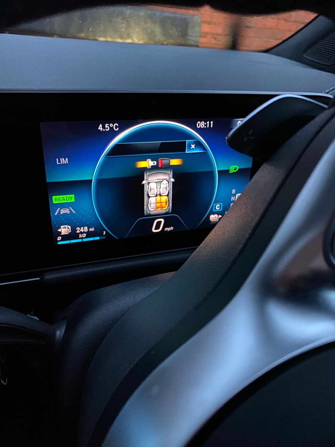

Hi all
I bought a new GLAe, my first time owning a Mercedes. Every time I get in it and start the car I get the pictured warning about seatbelts. There’s nothing at all on the back seats, but I get this every time. I’ve left the dealer know and they’ve advised it’s normal?!
is there anything I can do to stop it showing?

Originally Posted by MaseCTID
Hi all
if you have weight on that seat it will think someone is sitting there with the seat belt not attached
if it does this with nothing on the seat means your seat weight sensor is faulty or not calibrated
all this can be fixed and diagnostic with Xentry
and even if the weight sensor is faulty and you would not want to fix it now, this can be disabled
