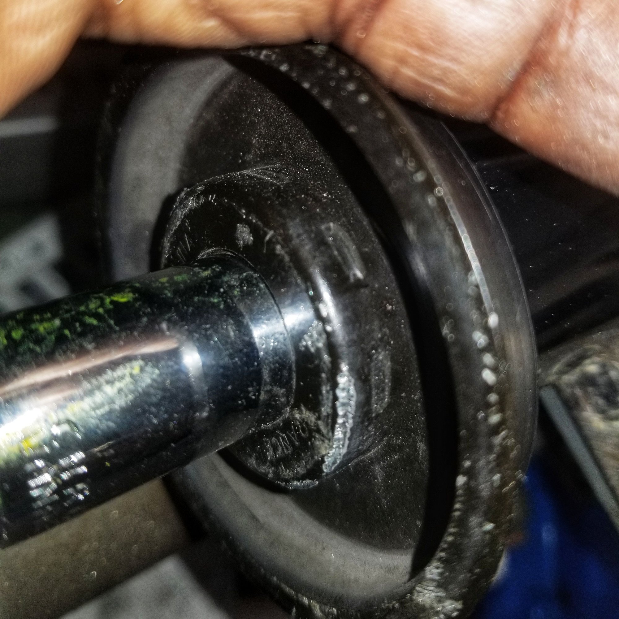

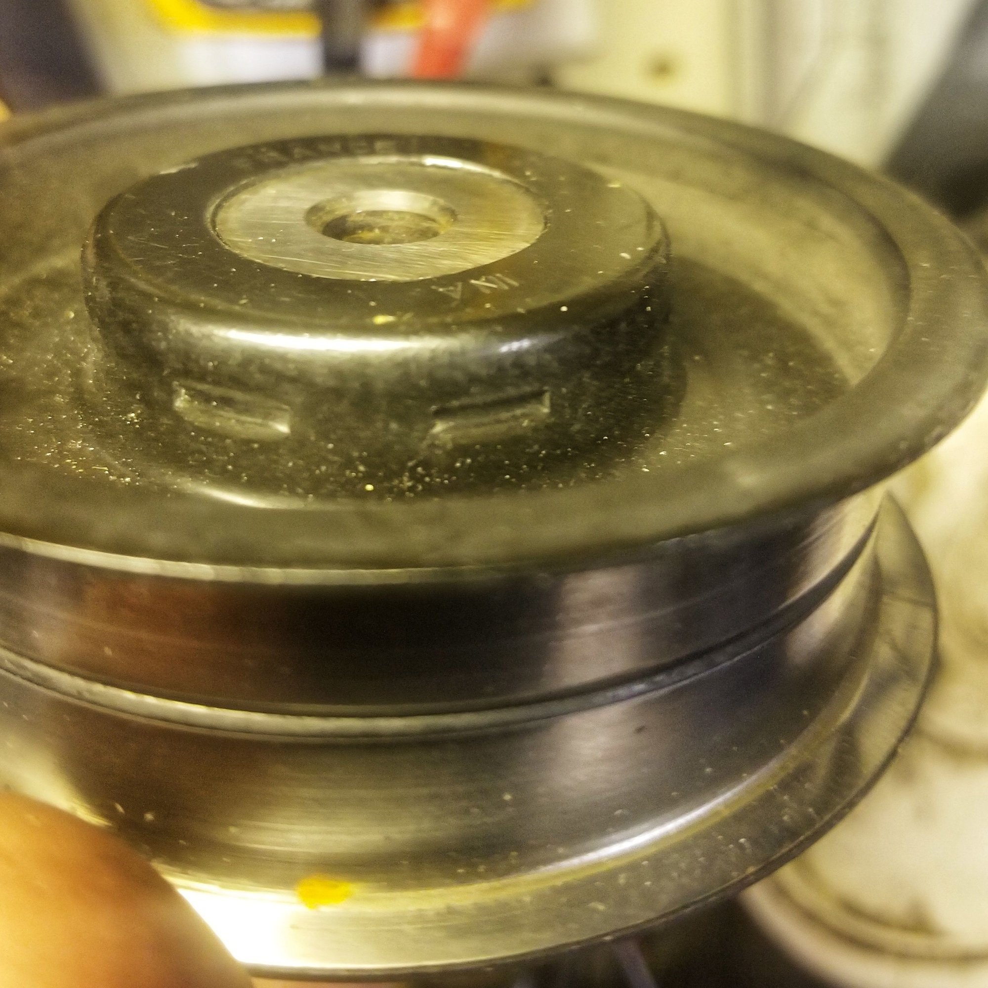

i went right out to the old pulley to see what you were refering to but i didnt see it. The whole middle section looks like 1 solid piece. I ran a metal pic along it but didnt catch any lip. There is also a grooved channel which runs right down the middle of part where the belt rides. Perhaps this is where the pulley is actually sealed? I ran my pick along it and it seems to be metal and not an adhesive.

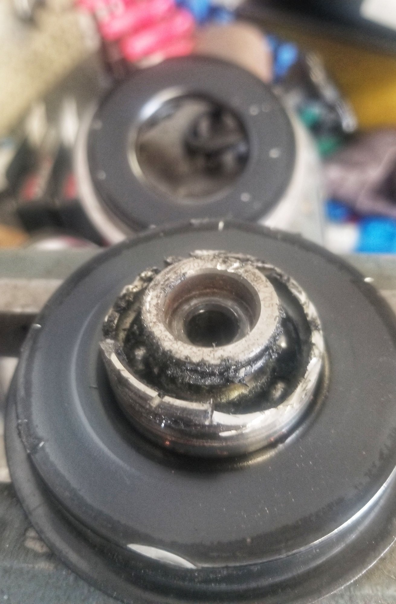

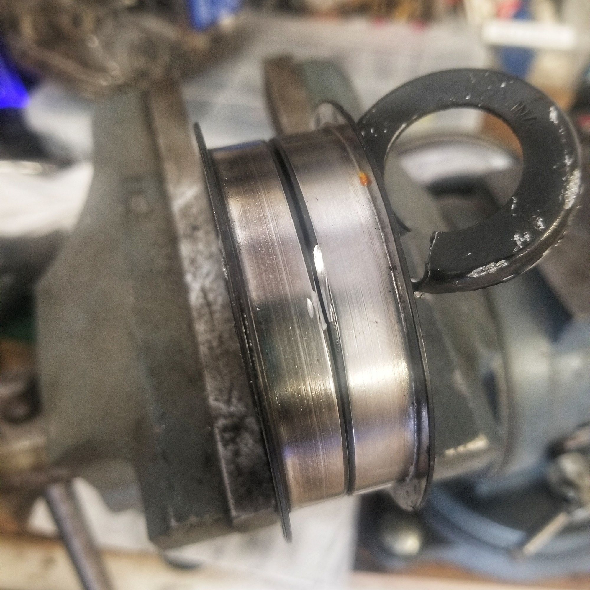

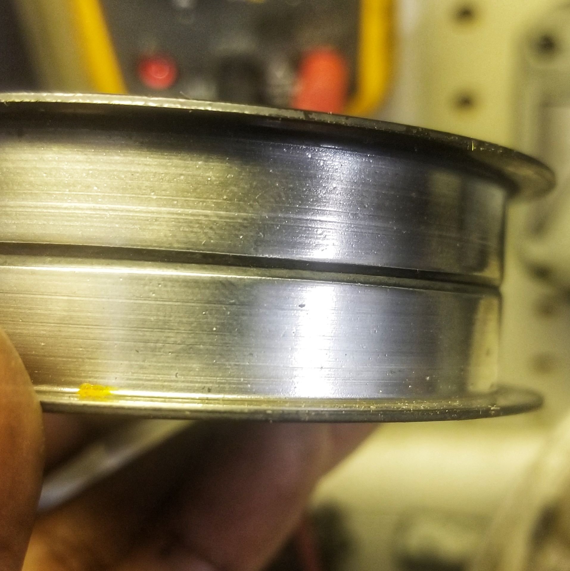

Am I seeing both sides of the pulley in pics 1 and 3? Assume I am -
Yes, that is different than the usual idler. It does look like perhaps the pulley splits in half, if so, it would need to be an awfully tight press fit, or adhesive; otherwise, stresses under operating conditions would eventually separate the halves.
If you're adventurous, try to split the halves with some force on the old one. See if it separates.

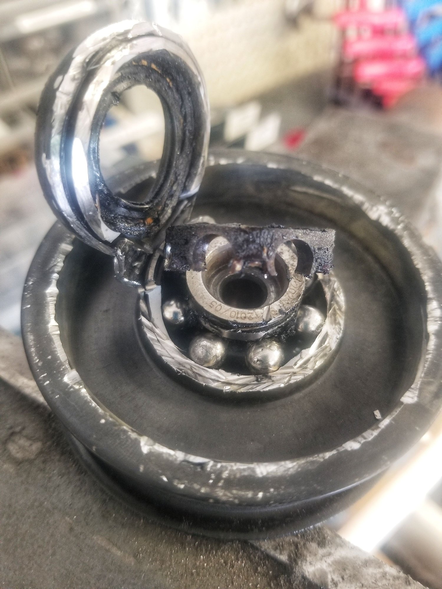

So I was indeed feeling adventurous this morning and decided to sacrifice my old bearing for science.
I took my dremmel and went to work. I cut at various spots to see what I could gleam but I ended up simply removing the top of where the bearing resided.
Here you can see there is the outer housing and the inner bearing which seems to be pressed together.
I cut some more to remove the ball bearings from one side. Then I started to dissect the line where the belt rides and as I was clamping it down it actually separated just a hair from the clamping force on the other side.
This is a photo of the top half removed.
So I figured I could get the inner bearing out with a simple vice/press but it proved VERY difficult.

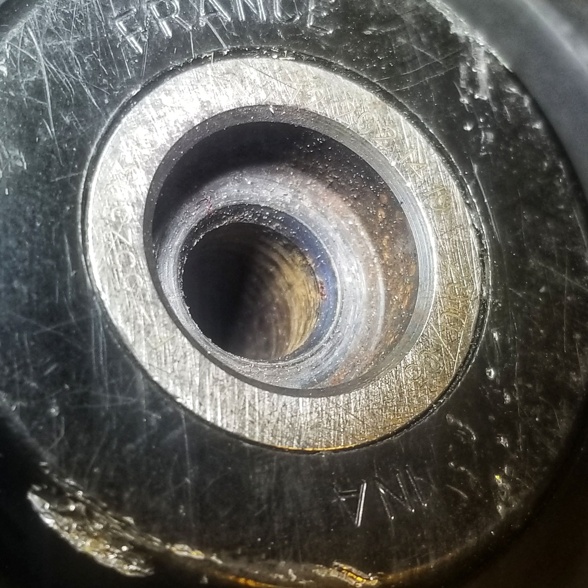

When I examined it a bit closer I realized that the stamps in the metal around the inner bearing were holding it securely to the outer housing.
That being said there is no way to get to the inner bearing to service it without utterly destroying it.
But I also noticed that there was almost no way for water/dirt to really penetrate that inner bearing either.
Even if completely submerged I don't see hardly any water getting in. So if anything this examination gave me confidence that, baring a manufacturer's defect, my new bearing is good.
