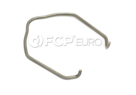

My coolant vent line on my GLe63 broke. I am looking at how it is attached and it seems like there is a bent metal paperclip holding it together. Before I do anything stupid, can someone explain how this comes out? Do I need any special tools to disconnect/reconnect this line?

Are you talking about this? You should be able to pull it up without it coming completely off. If it does, you can put it back on.

The bump midway on the clip is so you can get a flat-tip screwdriver, pick, or other tool to lift it.
