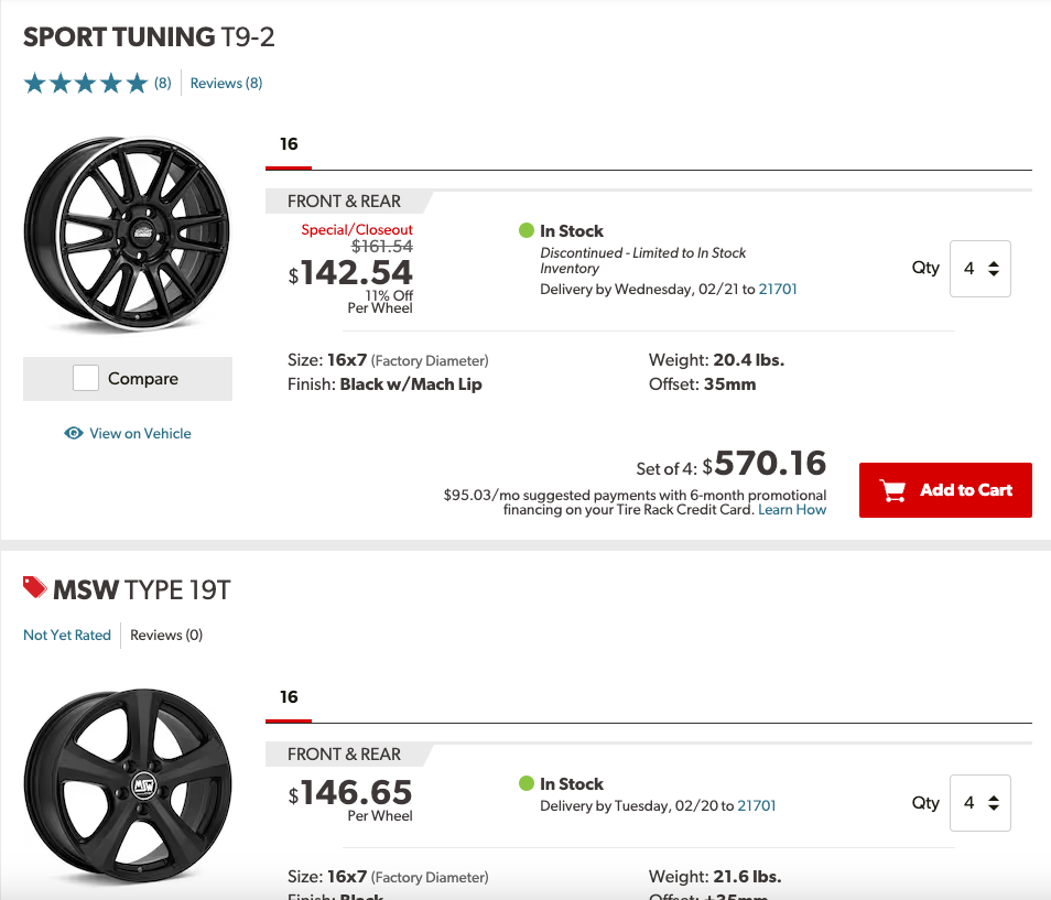

Go to TireRack.com and see what alternative sizes will fit you car. You can also check your Operator's Manual for Winter Tire sizes. I doubt, however, you can fit 15" wheels over your brake calipers. 16" may be the smallest you can go.
Since the C200 CDI wasn't offered here, I selected a C280 and the smallest offered are 16".
