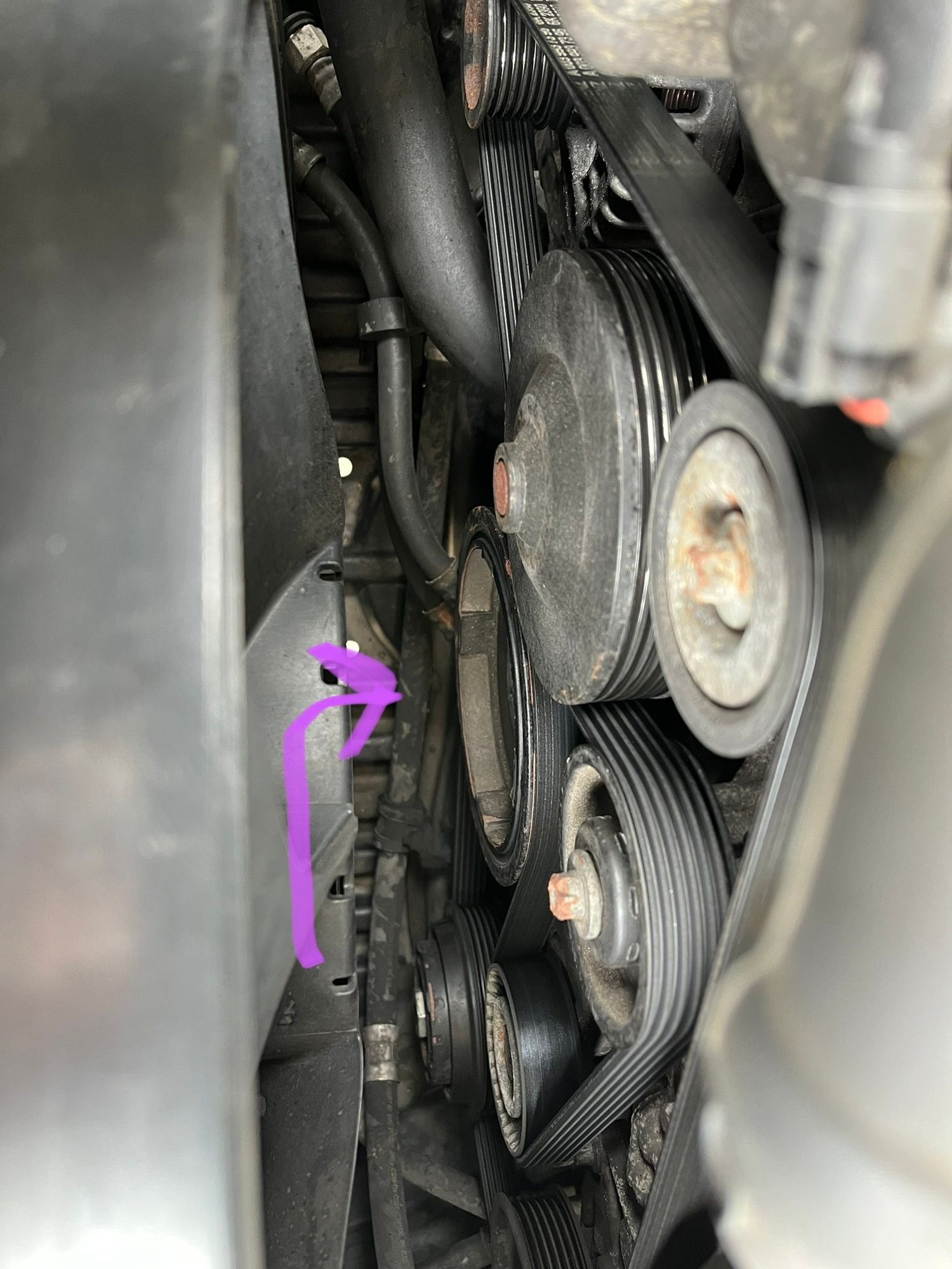

How accessible is the crankshaft in this car? What size socket might I need to rotate it for the test?
I'm prepared to do this test today, including buying a GoPro to make a quick video of the process if it's not a nightmare to turn the crankshaft.
Just checked under the hood, is it this one?
Doesn't seem horribly inaccessible. Not seeing a bolt head on it though, any idea what size?

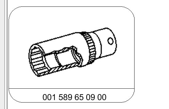

"Special Tool Time." This is the socket you need to rotate the engine by hand. See attached.

THANK YOU SO MUCH!!!

You might find something like this in the aftermarket. Google the part number. Good Luck
