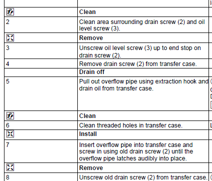

I am performing the Transfer case oil change on my 2017 E400 following the WIS procedure. I unscrewed the oil level screw and then removed the drain screw. A little oil came out. I then went to remove the overflow pipe using a hook like WIS says. However, there is no overflow pipe. The car only has 33k miles. I am pretty sure this is the first time the transfer case has had an oil change. The oil that did come out was blue. Has anyone else seen a transfer case with no overflow pipe?

Update, I was completely wrong. The overflow was there. I was not using the right hook. I ordered a set of hooks off Amazon using the parts reference from WIS. The hook came in the next day and pulled the overflow right out. Right tool makes all the difference. Sorry for the confusion.
