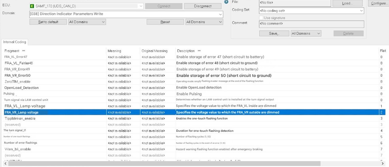

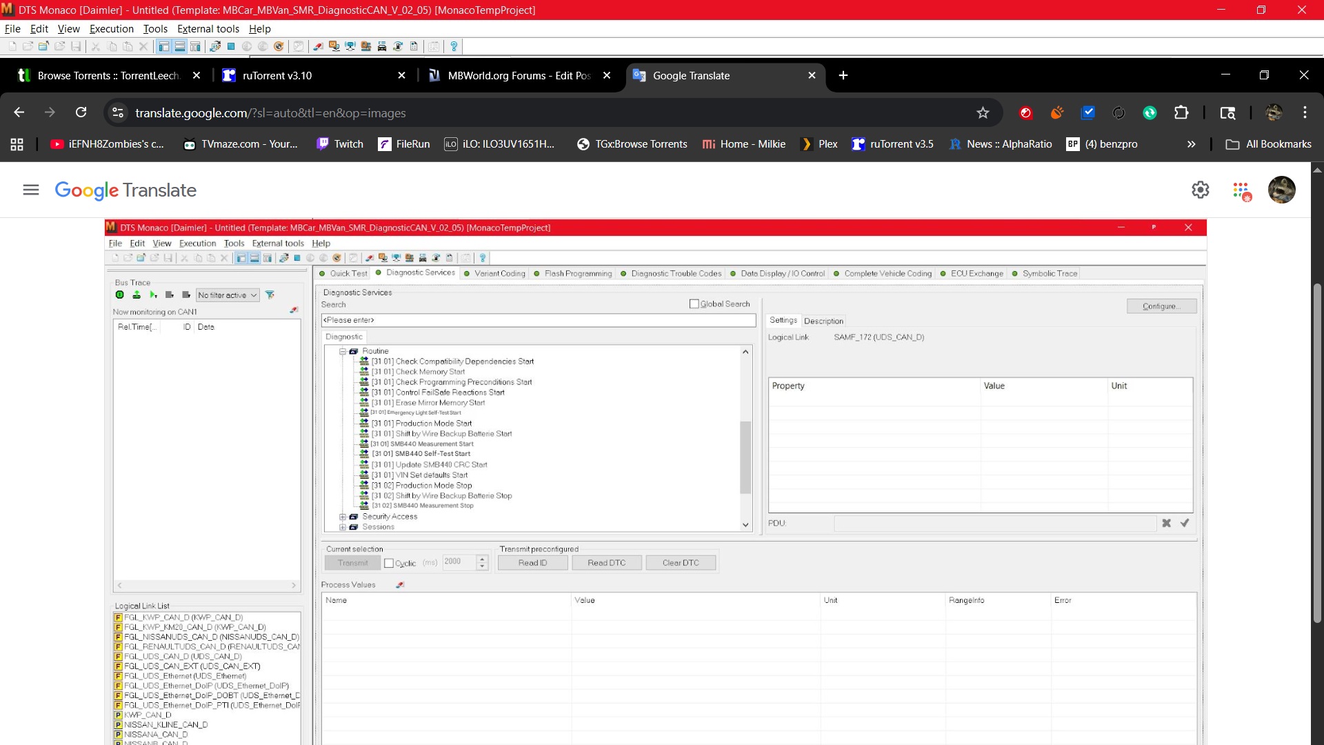

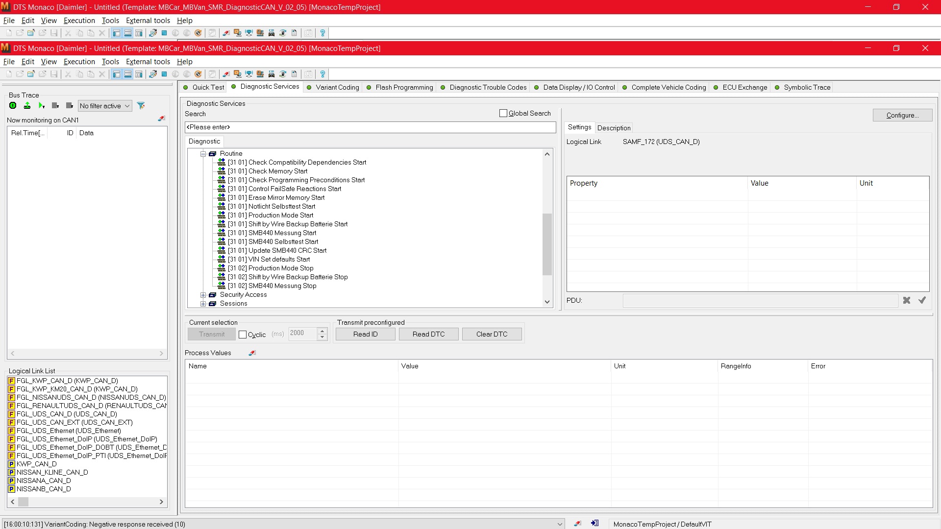

So I'm learning and am currently playing with variant coding my front Sam turn signal pulses from 3 to 5. I write the new code and it reverts back to original coding after the car falls asleep and wakes up or if you do a hard reset of the module. So I read online that i need to save the variant coding to permanent memory. This is where I'm stuck at. The first two photos show the variant section that in trying to change one converted to English. Its in simulation mode because i forgot to take photos with it hooked to the car. The third photo is the diagnostic tab with where I believe the setting to save to permanent memory is nowhere to be found and the third photo and the fourth photo is converted to English.

Sure, the revert is common. That "save to permanent memory" option can be hidden in Vediamo. Try it again with the car connected, not in simulation. The button might appear.

Thanks for the info . I have tried with the car hooked up and the menu options are the same. Since I forgot photos I just used sim mode because i needed pics. I just looked at the BimmerCode web site and Mercedes isn't supported. The coding is pretty easy I just don't know how to make my changes permanent. I may have to switch and use Vediamo but I am more comfortable with DTS Monaco.

You were correct. I had time yesterday to plug into the car with it on the battery charger. To translate all the modules into English and went thru every mode and sure enough there is a download folder that I only see when hooked up to the car. Taking the time to translate everything helped me to see my mistake of thinking they were the same. Of course I forgot to screen shot it. I will post that soon for others to stumble onto this thread. Next learning experience will be learning the correct way to use a seed key calculator
