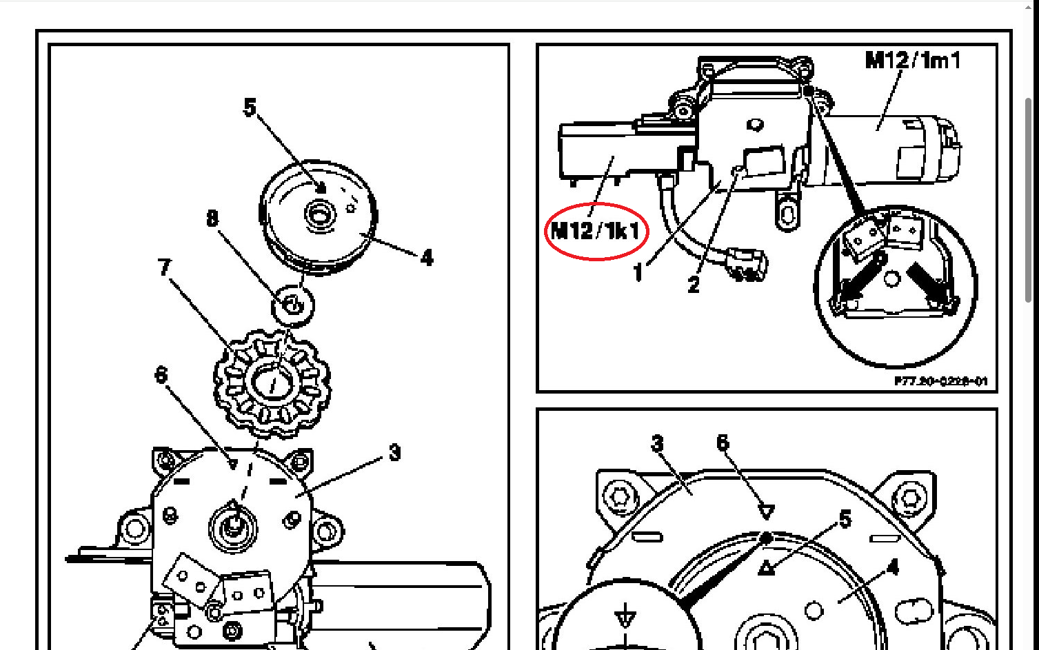

The sunroof relay M12/1k1 is at the motor M12/1m1.

What is this relay and where is this located, is it coupled with the sunroof motor?
Do you refer to this?

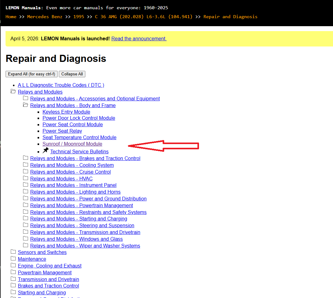

The manual shows that relay up in the overhead console where the sunroof buttons would be.
I was looking at this online manual here: https://lemon-manuals.la/Mercedes%20...d%20Diagnosis/
For the relay location I looked under Relays and modules > Relays- Body and frame > Sunroof.

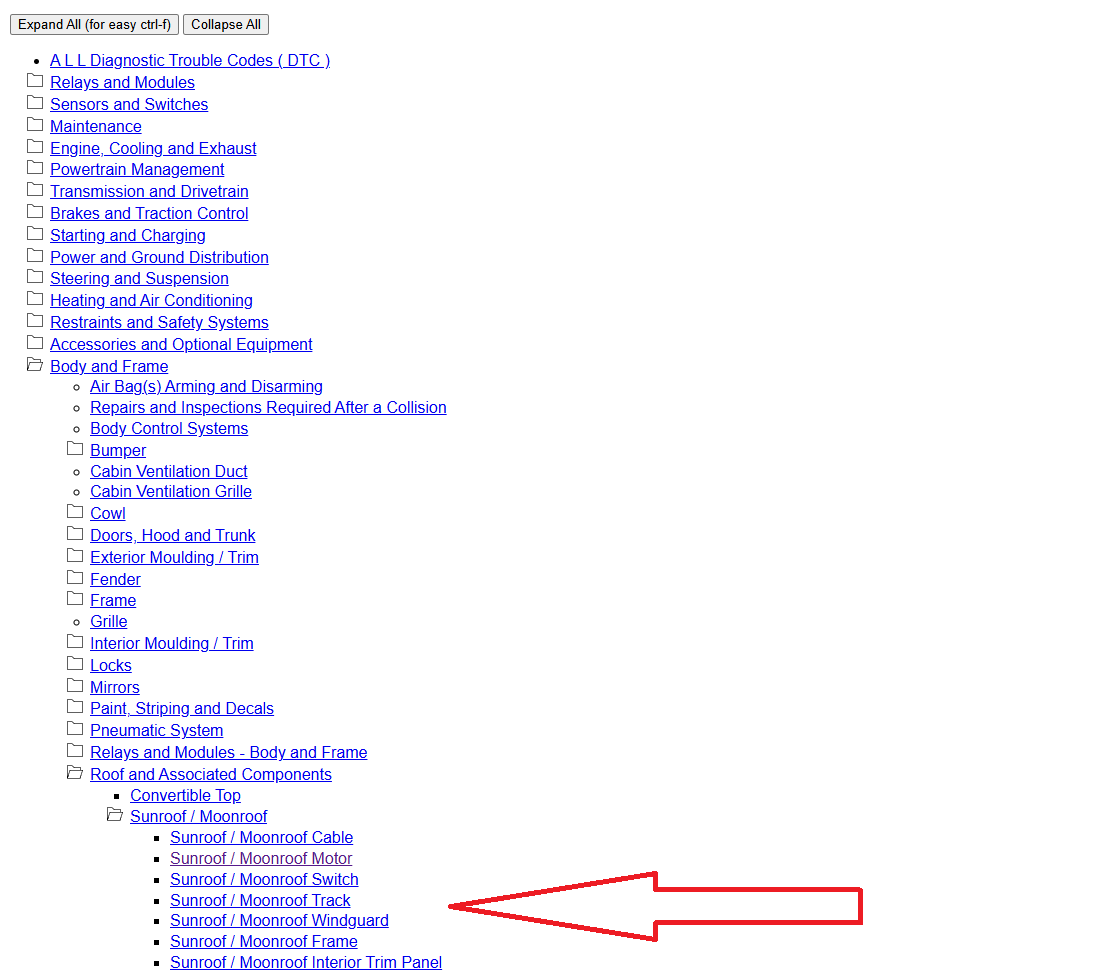

Also look under Body and frame > Roof > Sunroof.
