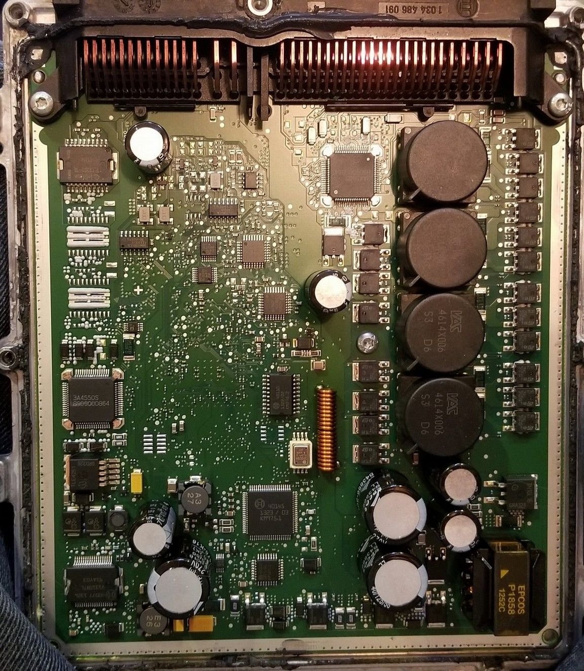

I would open the ECU to see if has oil in it. I think your car just might be a great candidate for my redneck mod to suck the oil out: Link
I did this over three years ago and it still pulls the oil out and my ECU plug is bone dry. I have a little bottle, maybe 2-3oz, that collects the oil.
Opening the ECU isn't too difficult, but not exactly fun. Remove the screws, obviously, then pry the cover off with a screwdriver. The silicone was pretty strong on mine so I pried, then stuck a razor blade in the cut it, pry repeat. Don't stick the screwdriver or blade in too far because the board isn't too far away inside. See pix, and you can see the thin strip of black silicone all around the edge. And note the pins
I'd keep the ECU level in case there is a lot of oil in. See the copper pins from the plug extending to the board? That's where the oil comes in, so it would drip down into the pan "cover".
If you took the ECU off for that cleaning you mentioned and things went haywire immediately after, I would suspect said oil in now where you don't want it. You can still clean it with Alcohol. I'd use Ethanol or ISO, not Methanol. Or maybe soap n warm/hot water, but I'd rinse well with pure 0ppm water. Bottled water is often 0ppm. Let it dry, maybe with some heat, and see what happens.

Thanks for that advice, I opened up the ECU ( your right not an easy job), but everything inside was dry as a bone and no signs of oil residue.
All back together now, but unfortunately I still have the same faults.

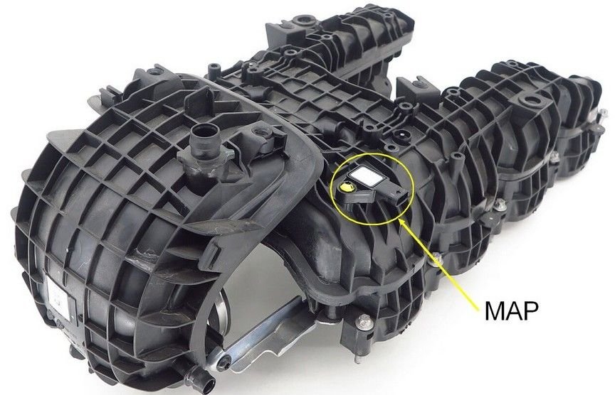

Can anyone tell me the exact locations of the pressure sensor 2, charge air sensor and the coolant temp sensor.
I am having trouble locating a diagram which shows any of the 3 sensors exact locations.

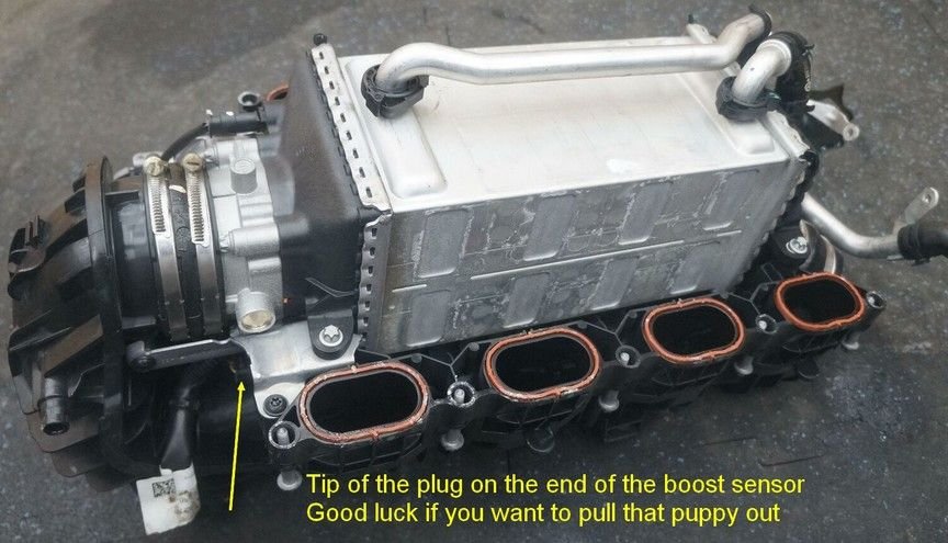

That's good news, because an ECU fail is big $. I'd check that the ECU pins are all straight, which I'm sure you did, but fyi. With all the codes being short to positive I'd still suspect oil still in the ECU plug, but a bad ground may also be the case. You could always make a new ground if you can't find the original.
Note links at bottom of post 7, that may help: https://mbworld.org/forums/e-class-w...cm-pinout.html
Vid showing boost sensor ~1:12
