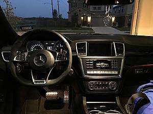

2016 Steering Wheel In 2012 ML63 (pictures)
Attached Thumbnails 2016 Steering Wheel In 2012 ML63 (pictures)-img_8107.jpg   2016 Steering Wheel In 2012 ML63 (pictures)-img_6917.jpg

Cool. You did the job?
No change in the steering column?

I had a local shop do it for me. The steering column didn't need to be changed. Although the supplier I bought it from shipped it with the contact plate that was specifically for the 2012 model just in case it didn't fit with the 2016 one.

$1500 for the steering wheel. $50 to install at a local shop.

1500$ is for steering wheel with a new airbag. Not bad

Unfortunately, I do not know the last four digits of the part number, but I am sure if you contact the seller, he can tell you.
I did use the newer contact plate and the seller put that on the steering wheel for me at no charge. If you do buy this, make sure you get the correct buttons. The ones that come standard with the wheel do not work for the W166's.

I got this wheel ready to go with airbag fits 2012+ models without lane assist
