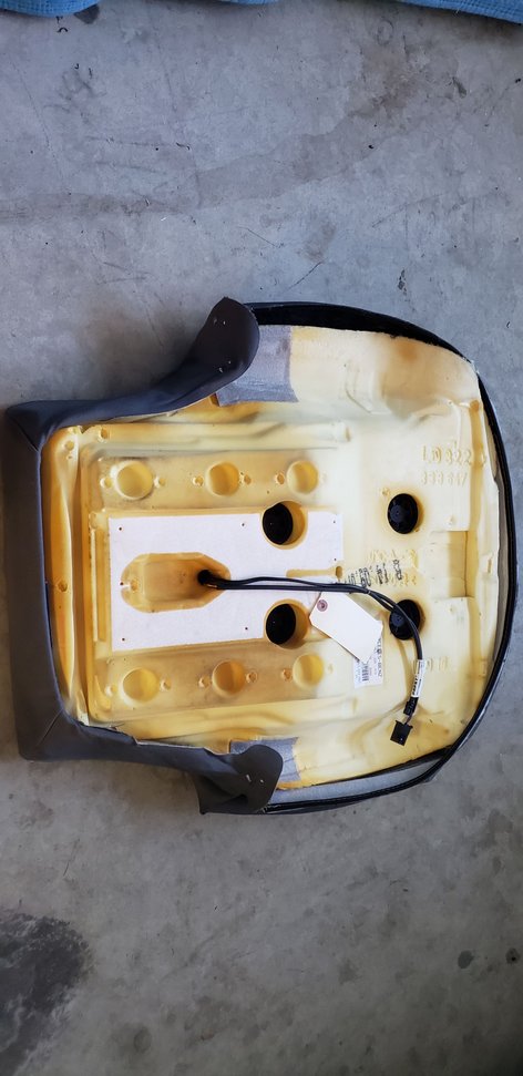

I need to replace the lower part of the front seat with seat cover and pad that I bought on Ebay.
Hopefully the whole seat wont need to come out of the car for this procedure, any input?
