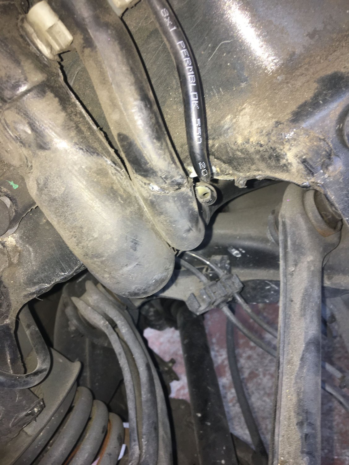

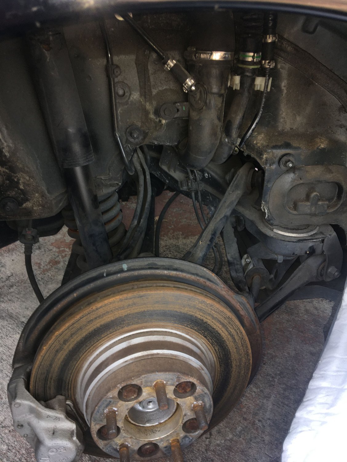

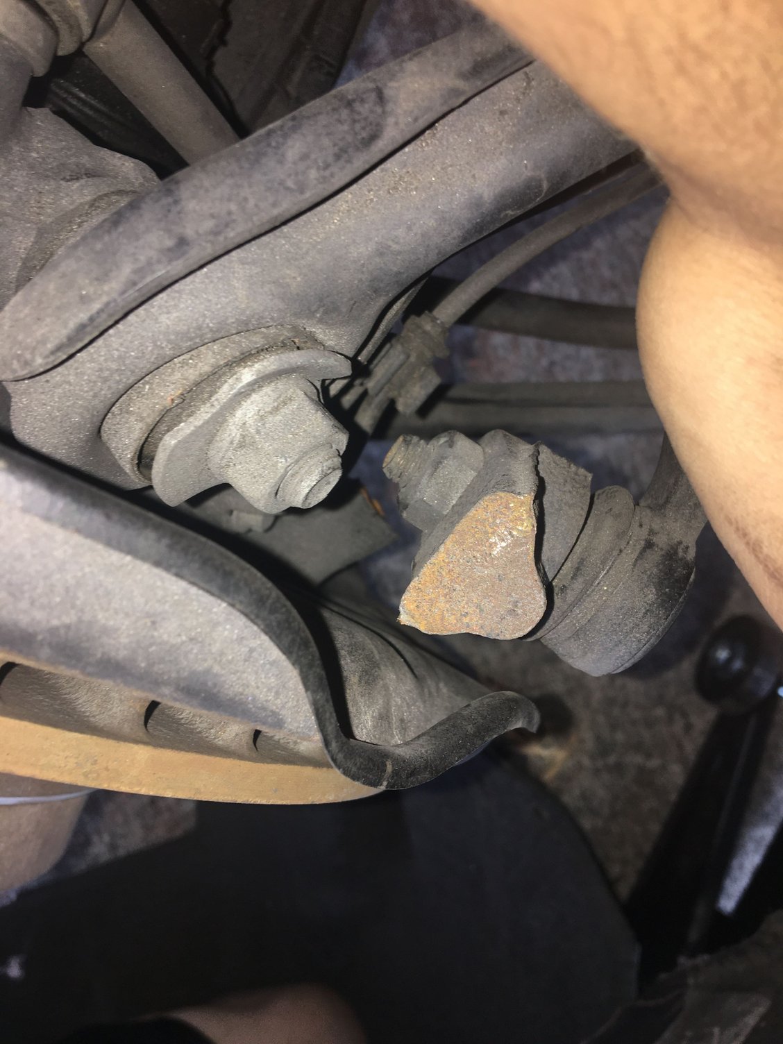

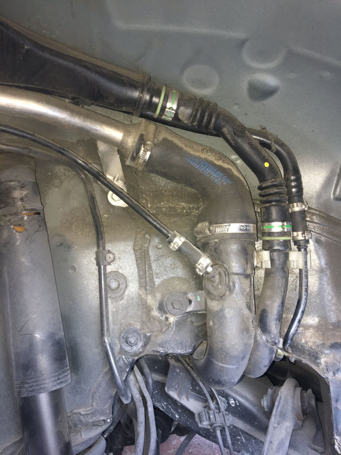

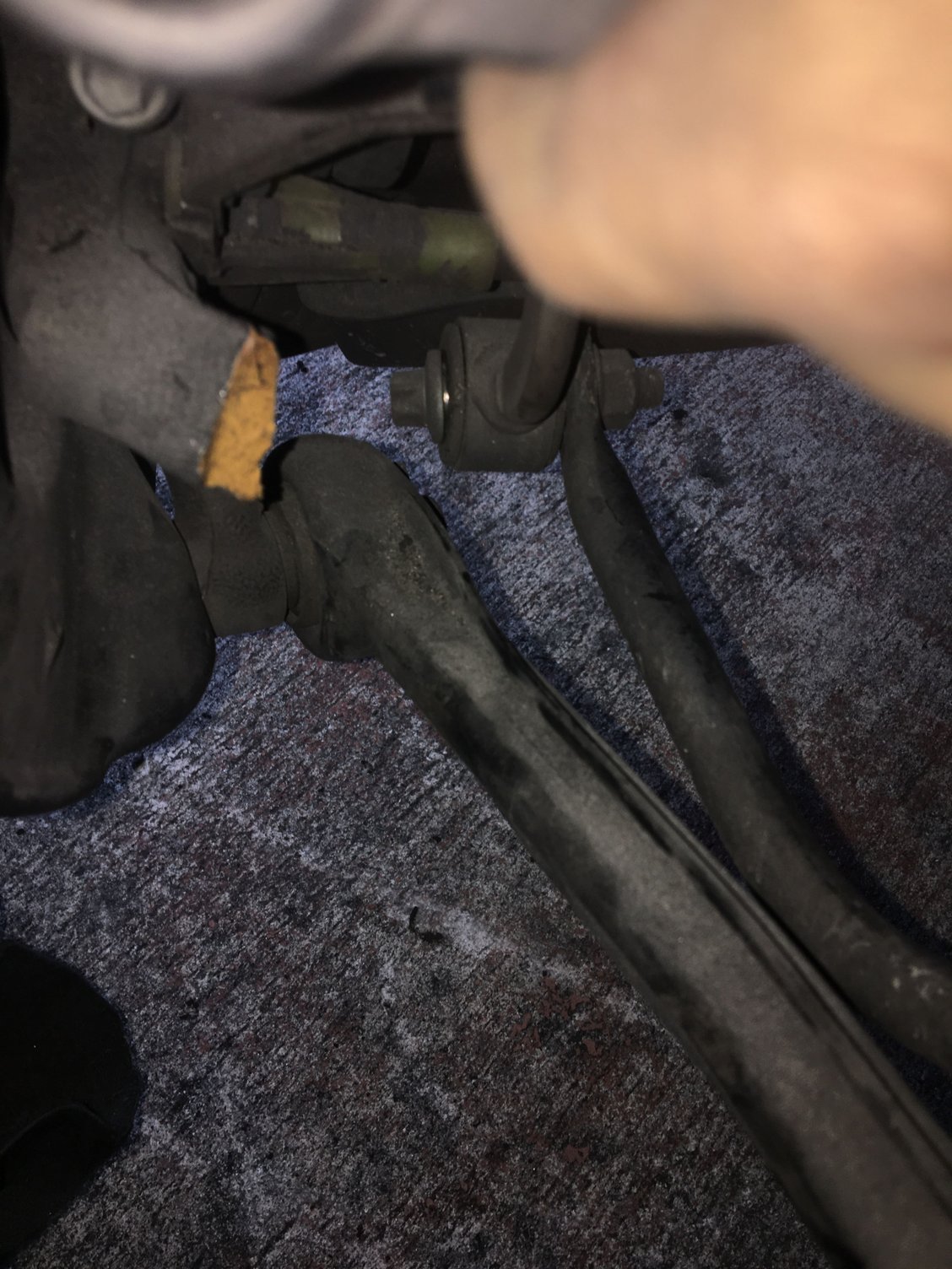

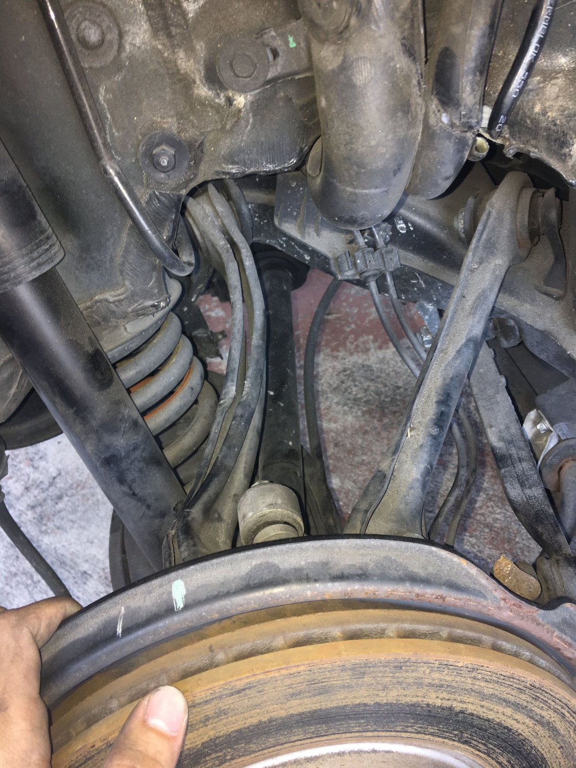

So I started taking the clk apart to look at the damage and this how bad it is. Does anyone know what those hoses do, I’m assuming that might be a reason why there’s an Evap leak code. But I also realized the part that snapped broke by where it connects to the disk, does anyone know what that parts called?

Welcome! Please post a photo of the CLK.
What caused the damage? It looks like either a stabilizer linkage, or a control arm or link that has broken from the knuckle (upright). A serious impact occurred?
The hoses from your photos appear to be fuel fill and vent hoses.
What is the entire story with this vehicle?

im not exactly sure with the history of the car, I bought it like this tryna fix the couple lil things wrong with it. So that’s what’s causing the evap leak. I’m tryna find exactly that part that connect to that control arm so I can change it, ima have to do it to both sides

Can you show both sides of the rear of the vehicle? Do you know the reason that one headlamp has been replaced? Has the vehicle been in a collision?
