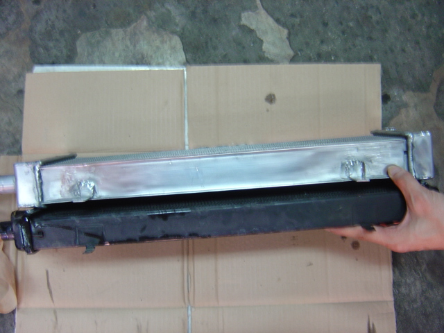

Installed the new intercooler !
Members with gauges read 1~2 C coolant temp drop.
Though it's build for S/C,keep lower inlet temp means power.
(0) Al based intercooler
(1) 11 -> 14 columns
(2) Thicker
sum to 1.8X capacity than stock

Old Aug 2, 2003 | 08:10 PM
Shine's Avatar
Joined: Jun 2002
Posts: 972
From: Lean runner
Smile
the side view......thicker

The Kleemann cooling system is seperated out of engine cooling loop,only share the reservior.
I notice there's still 1~2 C coolant temp drop. So at the intake
it must be much lower temp.
Feel stronger TQ so far
