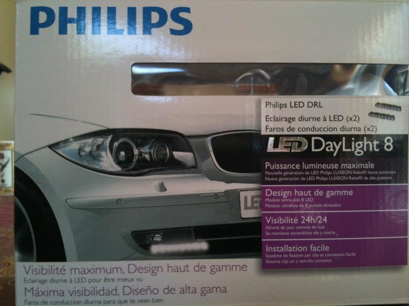

Newly Installed Philips LED Daytime Running Lights
Just installed Philips LED Daytime Running lights.
I have tried a few of them but I am very satified with Philips Brand.
Here are the photos:
Attached Thumbnails Newly Installed Philips LED Daytime Running Lights-1philipsled.jpg   Newly Installed Philips LED Daytime Running Lights-2philipsledoff.jpg   Newly Installed Philips LED Daytime Running Lights-3withenginerunning.jpg   Newly Installed Philips LED Daytime Running Lights-4fullpoweron.jpg   Newly Installed Philips LED Daytime Running Lights-5fullpower2.jpg
