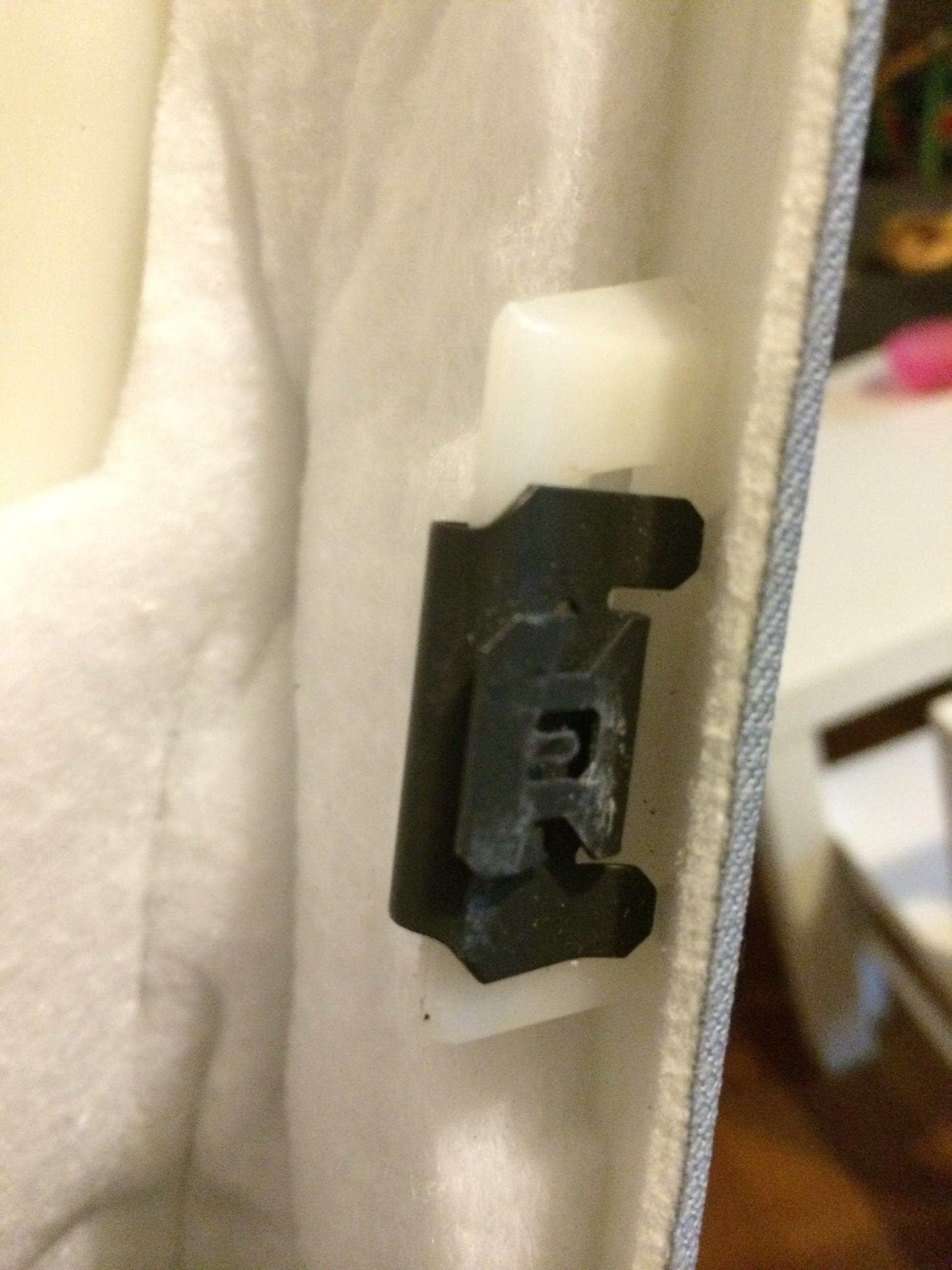

I managed to get the a pillars on properly. The front section of the clips needed to be pried open a bit to latch onto the metal pillar.
Have also managed to find some 2nd hand motors but don't want to take the risk. Will keep an eye out for some cheap new ones.
