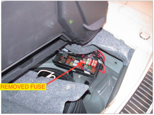

My 2006 R350 electrical system had a total upset this week. After starting up, the engine ran fine, but all warning and caution lights started to blink on and off. I heard the tail gate unlatch and latch again continuously, and exterior alarm lights were blinking. My sons called this “glitching". Quickly I switched off the engine and took key out, but still had warning and caution lights flashing. Alarm sounded occasionally, while locking and unlocking the doors worked only intermittent.
Called, then went to the local Mercedes garage. While driving, I noticed when I attempted to open the tailgate with the switch that’s in the driver’s door, the flashing of lights momentarily stopped and then started again. This interruption of flashing of lights and latching/unlatching of the tailgate got my attention and I mentioned it to the garage. Upon arrival the car battery was disconnected to avoid draining. I suspected something like chafing of wiring that had to do with the tailgate.
After a one hour investigating the problem, they found if they pulled a 40 amp (orange) circuit breaker from the rear fuse box (right of spare wheel, see attachment), the flashing of lights and continuous latching/unlatching stopped. All wiring that was related to the tailgate latching and tailgate motor was inspected and seemed to be undamaged. Putting the fuse back immediately caused blinking and you could hear the relays switch about every second.
Pulling the fuse solved the problem, but it created a new situation where some items don’t function anymore:

Attached Thumbnails R350 electrical problem. Tailgate? Help needed-r350-rear-fuse-box.png
