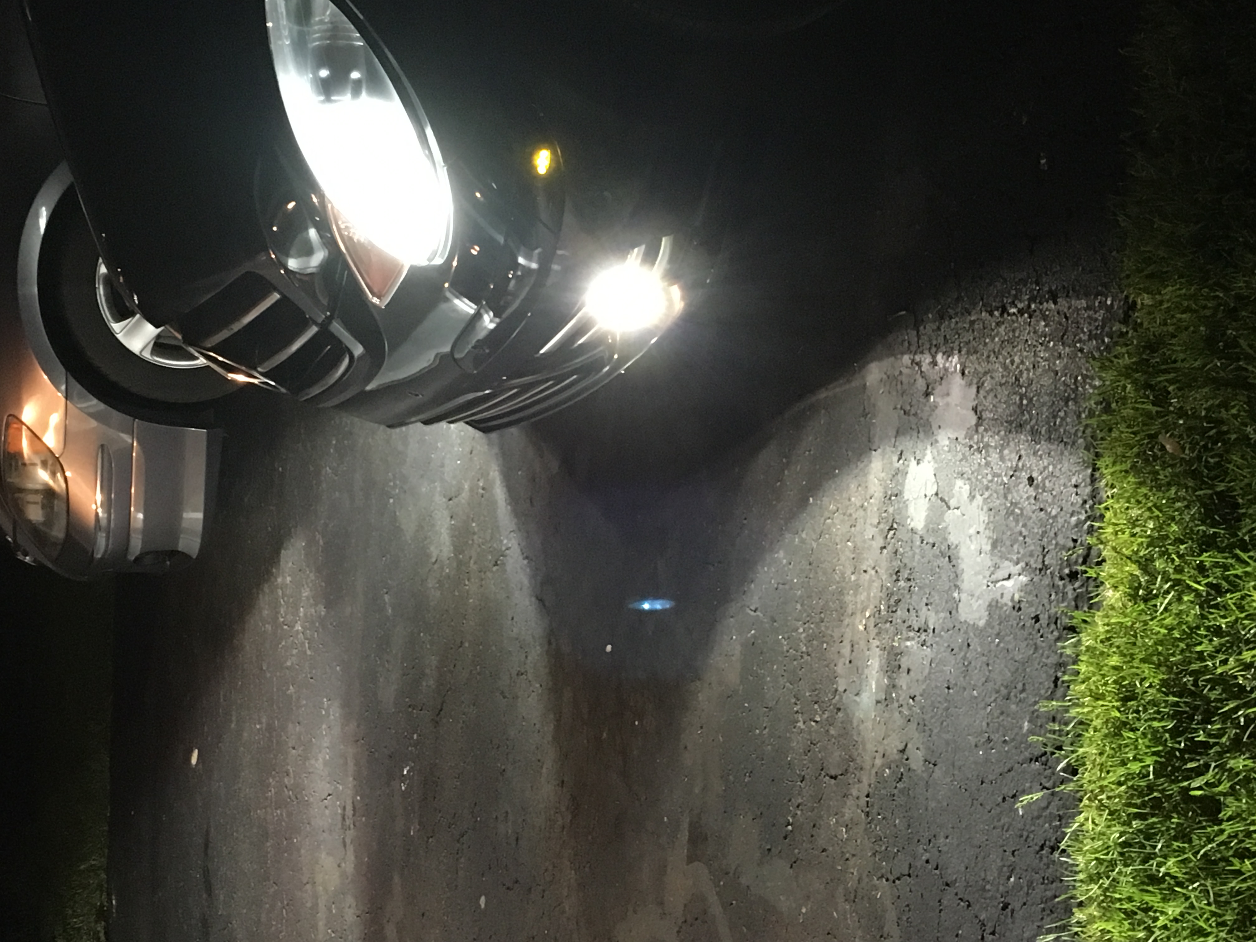

ABA / ESP warning error had not come back.
Attached Thumbnails ABS/ESP warning message after install aftermarket HID light.-img_4662.jpg   ABS/ESP warning message after install aftermarket HID light.-img_4661.jpg   ABS/ESP warning message after install aftermarket HID light.-img_4660.jpg
