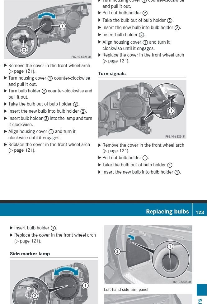

I had to change the turn signal lamp on my 2012 R350 with HID lamps.
The manual says:
Manual lamp number 2
manual how to change lamp number 2
I replaced the lamp with an LED version. After that, I recognized, that there is another lamp, right to the middle. Why? The LED switches on and of very fast. The old bulb was kind of blending in and out. You know, this kind of effect brake lights have (LED vs. old school).
There are two turn signal lamps per side. The first I replaced, is marked pink. This one is mentioned in the manual.
The other one is marked green. How can I change this one?
