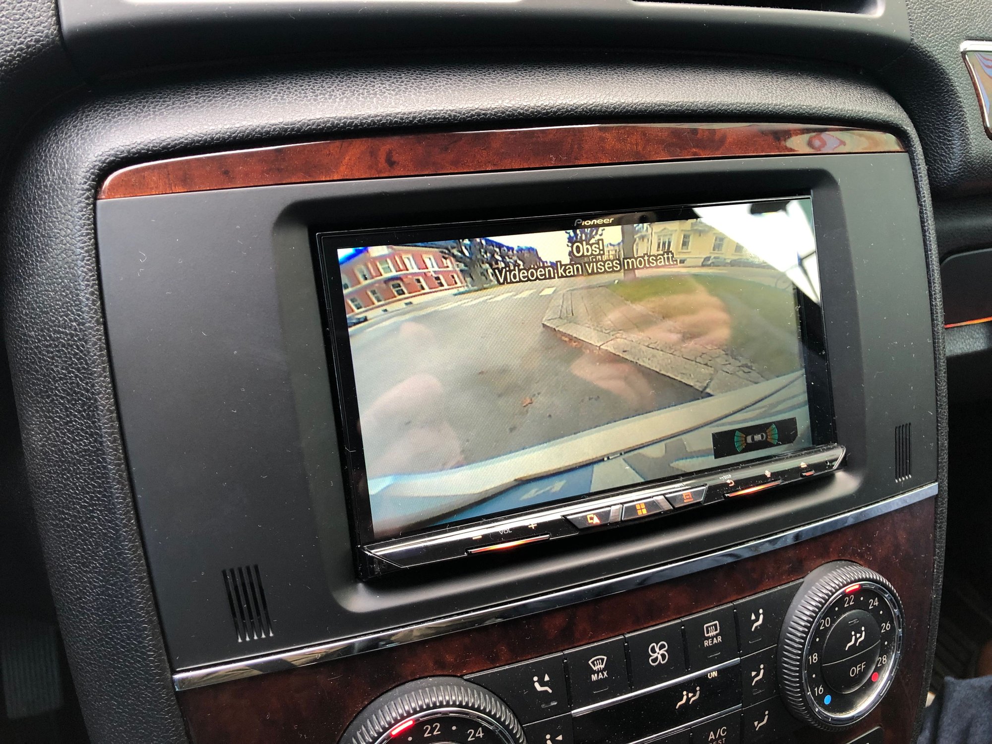

Since our 2007 R320 has been without big faults and i love the car we have decided to keep it as long as it's running and staying in one piece.
Now that the desicion is made there is only one flaw with the car, and that is the old and outdated COMAND system.
After thinking about it for a while we have now made the update and the result is amazing compared to the old unit. The car now feels way more modern now. Since i'm living in Norway DAB radio is the only option so a DAB roof mounted antenna was purchased and mounted, so was a universal backup camera witch was mounted in the factory location. I did not instal it myself, but had a shop do it and i was glad i did. Because the result was really nice.
If you are growing tired of your old unit an upgrade is the way to go, you will not regret it!
Old unit.
New unit. Pioneer AVIC-Z910DAB in navi mode.
Bacupcamera.
Shark fin antenna.
Microphone.

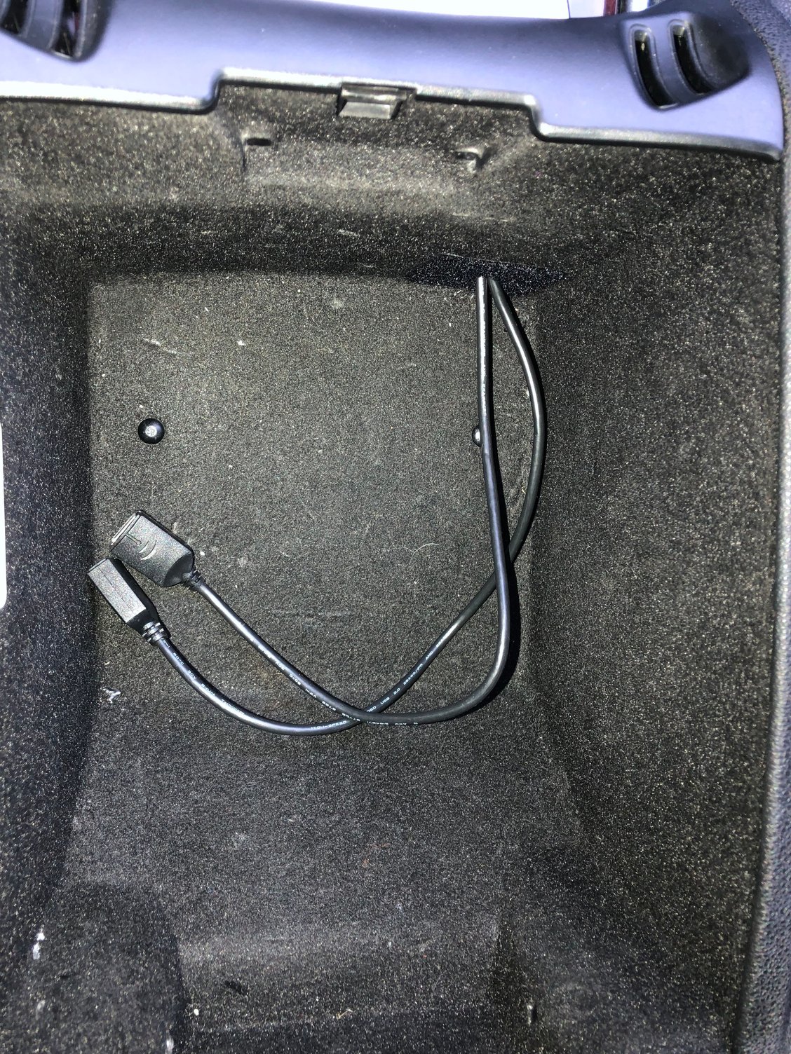

2x USB for charging and music.
Backup camera in factory location.

Are you talking about the black front cover/panel?
Old Jan 22, 2019 | 06:45 AM
vikramms's Avatar
Joined: Mar 2013
R350
Yes. the front panel.
Vikram
Old Jan 22, 2019 | 10:34 AM
TerjeR's Avatar
Joined: Nov 2018
Posts: 12
2007 Mercedes R320
Vikram
I ordered it from a dealer here in Norway, but you can buy it on ebay. It’s the same as mine.
