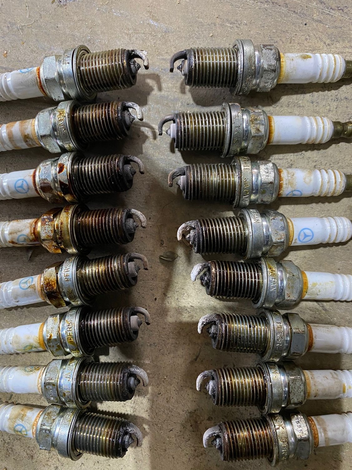

I started off with the plugs, coils and wires. Relatively straightforward job, two plugs for each cylinder did double the work. Interestingly the Bosch plugs which state they are gapped to 0.040" actually all measured 0.045"-0.050" out of the box. Everything I could find suggested 0.040" was the correct gap, and the box said that as well, but they were set higher and also not consistent. As a note, some of my plugs should quite a bit of ash build up. The R500 does burn some oil on startup after sitting for awhile, I'm guessing valve stem leakage or something similar, she is getting up there in mileage but it isn't enough to need adding between service intervals. When measured, they all showed gap erosion to around 0.055" or so, so a good bit of the electrode was gone. Any other thoughts on my plugs?

Passenger Bank complete
Old plugs, NGK oddly enough, with Mercedes star on them

Seems to be running very well, time will tell I guess. The platinum plugs being incorrectly gapped was unusual to me, anyone else seen this?

They came out very easy, but what you described is normally how a remove plugs. These also had years of oily residue at the top end which seem to make them easy to remove.
