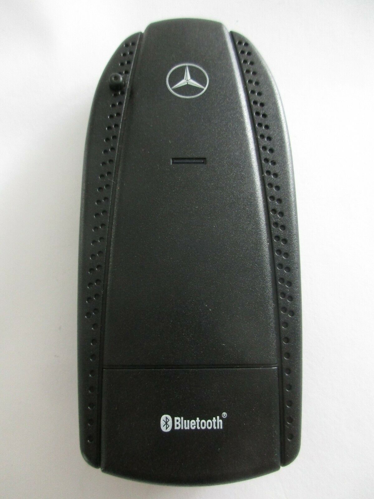

Bluetooth circa 2006 connects two devices only. Your HU says it's connected; does your phone? If so, have you tried a test call? Have someone call your phone while it's connected to Bluetooth; it should mute the radio (which must be on). Answer the call using the phone button on the steering wheel and you should hear the caller over the audio system.
I installed OEM Bluetooth into my 2006 CLK350. The systems of that era required a Bluetooth "puck" to be installed in the console, which looked like the photos below. Earlier, pre-Bluetooth Benzes I've owned had handsfree capability but required the use of a proprietary Mercedes-branded Motorola phone like the StarTac, Timeport and V60. Yours looks more like the even older versions of the console mounted phones with the classic "curly cord".

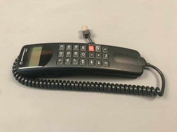

This is how the connection and the installed phone looks like. And unfortunately it cannot be removed or at least I couldn't.
When I had the mobile phone connected via Bluetooth, on the comand display it shows as connected, but not on the phone. I got a call on my mobile phone while the radio was on, but no sign on the comand. My mobile phone was the only one ringing. I have tried to remove the phone completely from the arm rest but I couldn't figure out how to do it, but I'll do that later if there's any reason. Below are 2 photos showing the connectors. Starting from that, what can be upgraded? I haven't seen any kits with this kind of plugs to be available.

Well, the phone seems to be there and it looks OEM. I have tried a SIM card (old style) and it works fine, but it is inconvenient for the driver and doesn't look good for road cameras of cops cars passing nearby.
I would've assumed a hard-wired OEM phone would have hands-free feature, even without Bluetooth. That was the whole reason I got an MB-branded Timeport BITD.
