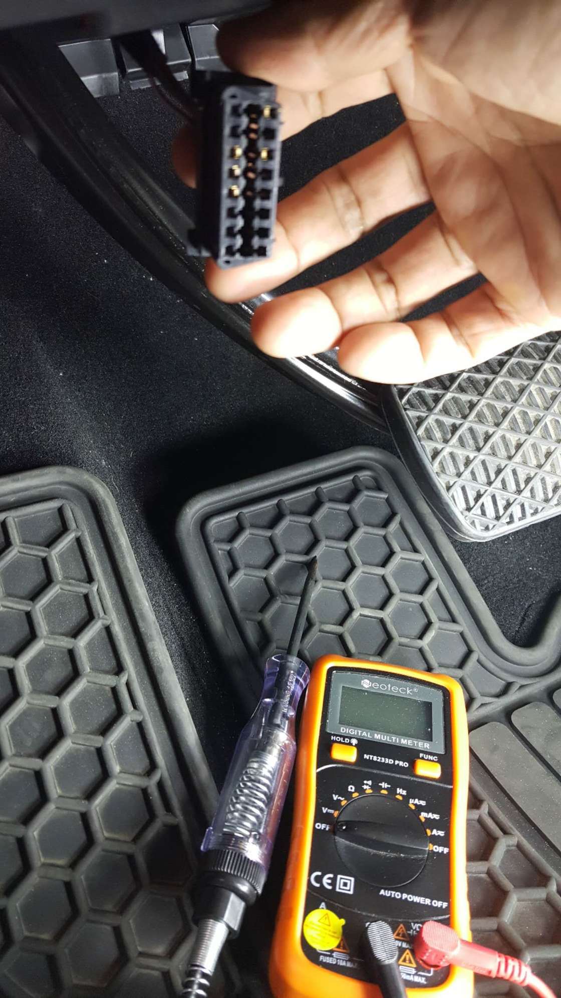

My OBDII scanner won't light up. I checked pin 16 has no power.
Checked the fuse #58 in the trunk has power: https://www.benzworld.org/threads/r3...ation.3087100/
In fact, I checked all fuses in the trunk only #49 has no power, all the rest have.
Battery just changed by myself, bought from dealer. OBDII has no power before battery was replaced, I thought was not enough voltage. Cigarette light port works fine.
Anyone has the wire diagram for this car? 2013 R350 BlueTec.

Did you check for power on the line coming into Pin 16?
