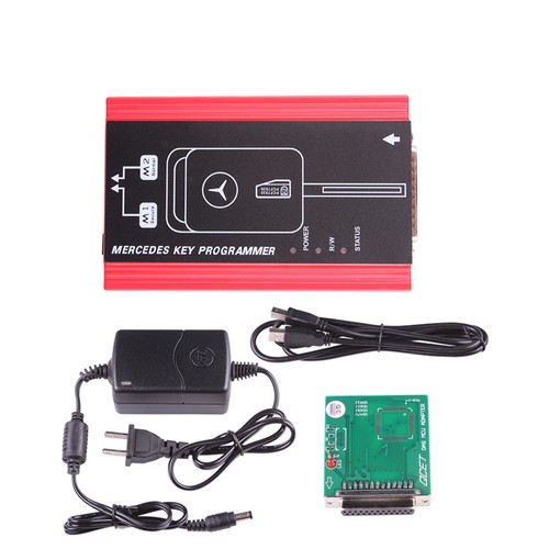

To get a new transponder chip programmed, you need to pull out the gauge cluster and remove the RCL control module.
Vehicles as of 12/94 and RCL control modules with part no:
210 820 21 26,
210 820 22 26,
210 820 27 26,
210 820 28 26,
210 820 32 26
Desolder the memory chip and solder it on a programmer adapter PCB like this. (On eBay they are around $75)
Order a blank chips from eBay, model Phillips PCF7930 or PCF7935
After you are done, desolder the chip and install it back in the RCL control module.
