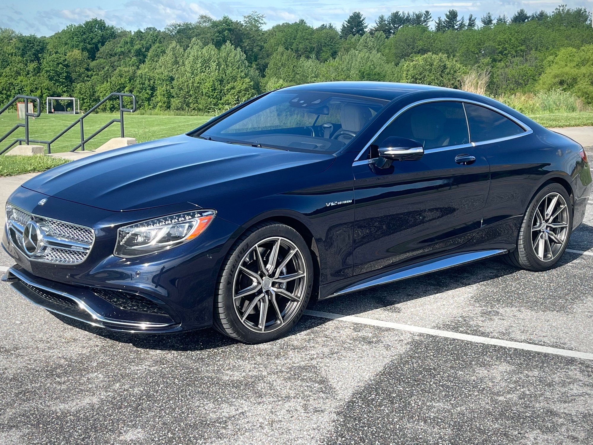

The guy that owned my car before me fitted Vossen HF-3 in 20X9 ET 32 and 20 x 10.5 Et 45. He also oversized the tires a bit, 275/35 Front and 305/35 rear. They don't rub at all. I switched my wheels back to a stock set as I wanted the OEM look though. If you are interested i have them just sitting in the garage now and would sell them.

Hi,
How much?
Last edited by xxnite2632; Nov 12, 2024 at 12:58 PM. Reason: Figured it out. The finish type from picture
