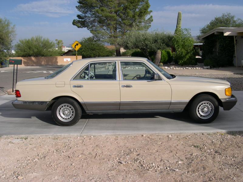

Here are some pics:

here is the horror in all of its gory detail. So to all of you posters with, gee I have this erratic idle but it runs fine otherwise, or seems like it is missing, or it dies when I slow down, or the vents don't quite work right, or why is that anti-lock light on, or why is it damp by the rear axle seals, or why is there an oil stain on the driver side of the engine block, or why does that pump in the trunk keep running longer, or gosh my reception on the radio is kind of crummy. Well, boys and girls, let papa olson tell you, you have no freakin idea just how many things can go wrong with these cars. If you are asking those simple questions, then you are too naive to own a MB, just put it up for sale for 10 or 20 dollars, or better yet, free to good home, and save yourselves a fortune. Consider the purchase price a relatively cheap price to pay to dodge the much more expensive hail of bullets coming your way.
I wonder what a restoration would have cost, probably would have been cheaper. Something to consider. All the griping aside, it is a nice car to drive when running right, has very classic looks, has an A/C system that will freeze you right out of the car which, in Tucson, is a very good thing. Parts were not that bad in hindsight, no more than any new car, but the labor is a mother. There are no cheap shops in my area that do good work. That will be real important for you if you intend to take the intrepid plunge.
I could not upload since the file was too big, I'll try something else.
