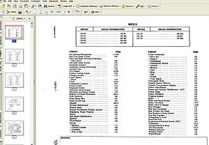

I have electrical manual but it have 50 MB and i don`t have a site to post it or a ftp.
