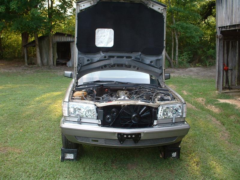

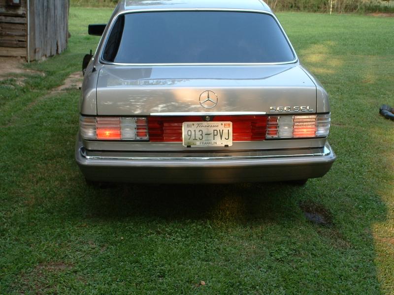

here are some pics of the 89 I am trying to save. no luck so far. but have not given up yet.
