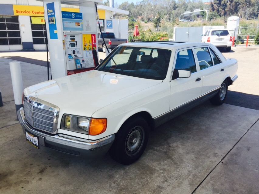

Ok, totally new to the forum, and not a car expert by any means. About a month ago, I bought a 1982 500 SEL. Grey market car.
It was a spontaneous buy from craigslist. Claimed that it only had 49,000 original miles, and upon inspection and a test drive it seemed to be in beautiful condition. No body damage, no rust, leather and dash are perfect. The mileage was suspect do to the fact that it said 50,144 miles when i drove it, but the odometer was not turning. oh, well i figured it was very clean and i loved the drive.
