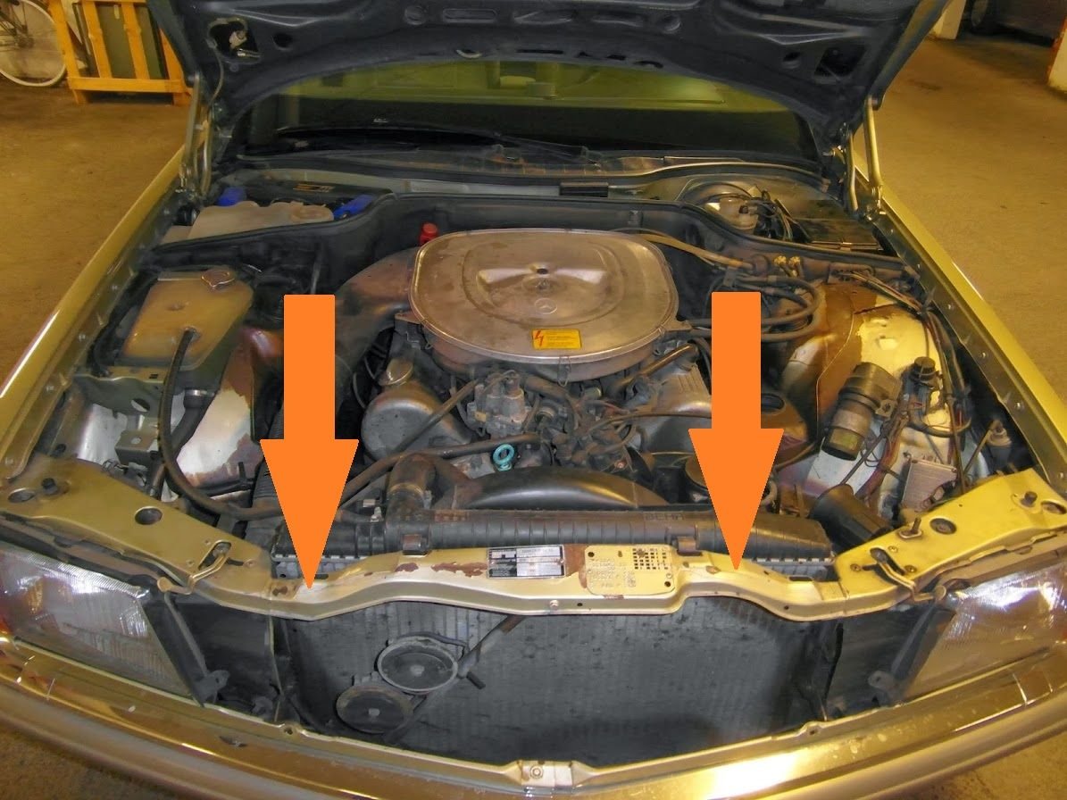

Hi and thanks for the membership
Hopefully my 82' 380 SEC will have a 5.0( M117) litre engine from a 84' 500 SE when the spring comes
Now the time is approaching for lifting the old M116 engine and autotransmission out of the car. So what is the easiest way to do it? Engine/trans together or separated?
The M117 and the related trans is separated. Should they be built to one unit before installing?
When the M117-engine was removed from the 500 SE together with the trans, the similar body part which the orange arrows are pointing at, was cut away. That car was a wreck so it was logical to do it. I guess its possible to get the engine/trans out of the 380 without cutting away this body part, just doing it with some more patience and time
