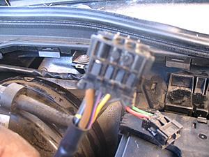

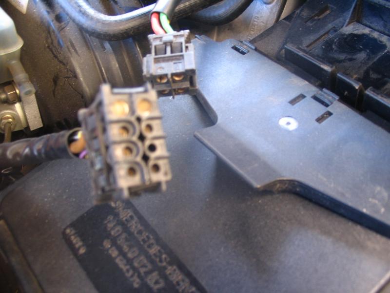

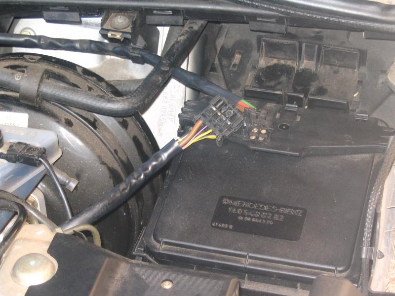

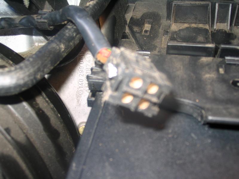

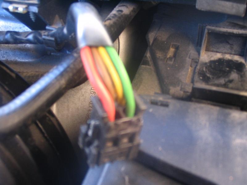

I have a 1993 300se and noticed two connectors under the hood, on the driver's side. the first one has 4 wires and comes from a box located under the main window wiper arm. The other has 8 leads, but 7 wires and comes from the fuse box. I've attached some pictures, Thanks for you help.

you're missing the wiper control relay. It snaps into the brackets you see in the first picture. Both connectors attach to the relay.
Do you windshield wipers work at all?
Here's the part you need - available for reasonable $ on eBay. Expect to pay $200 or so at the dealer.
