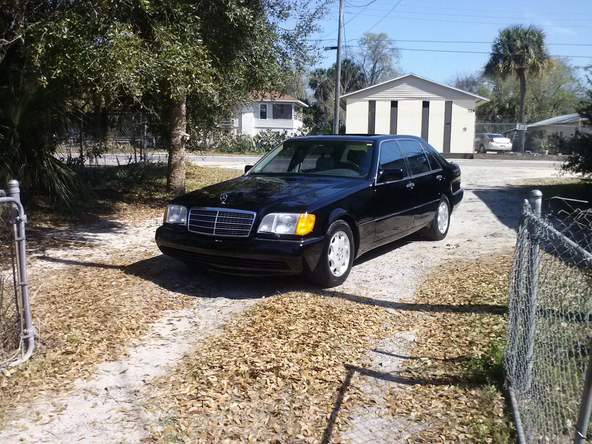

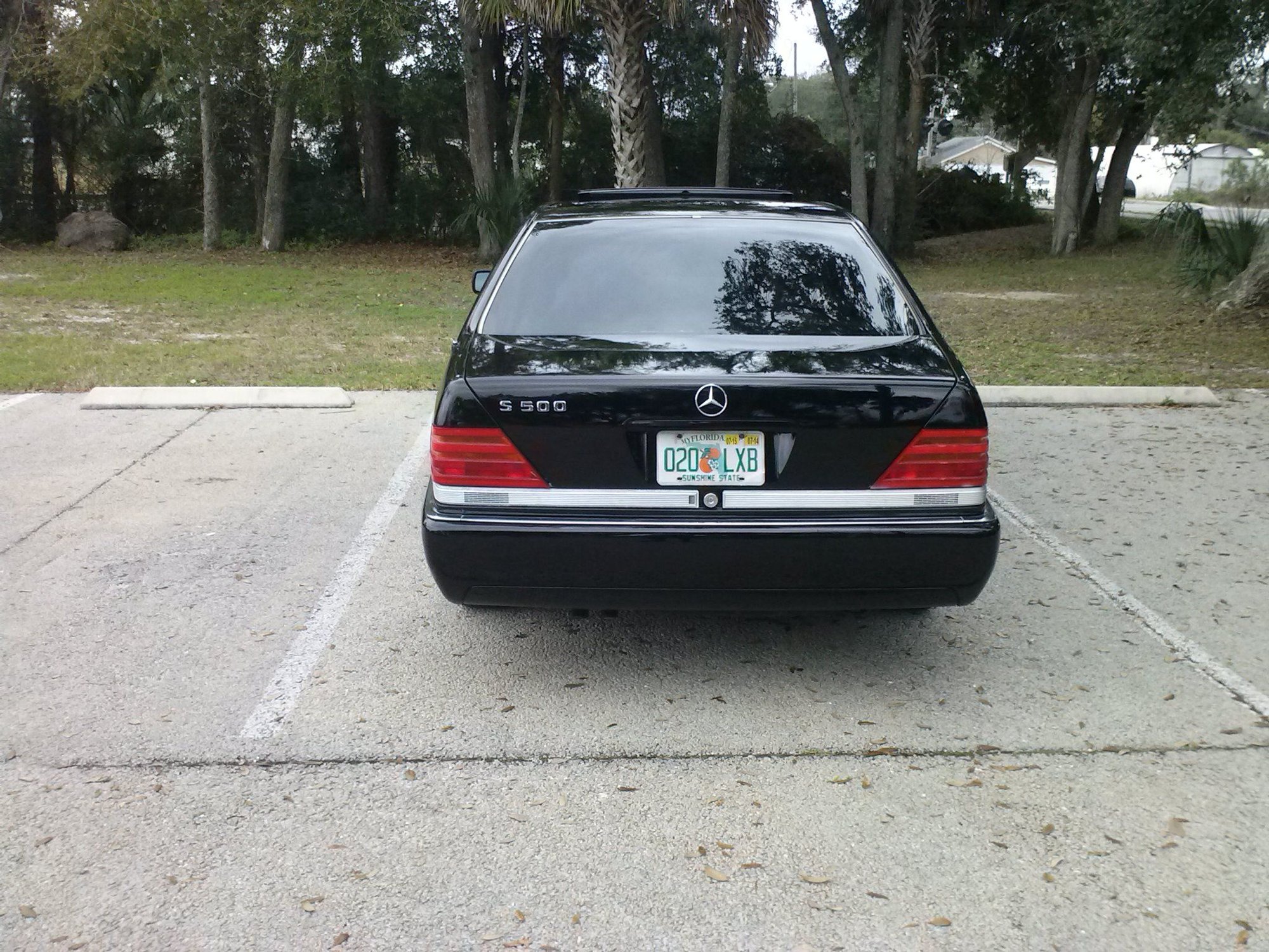

Hello everybody, my name is steve iam new to the group, here are few picts. of my w140 ...hope you like... however i wanted to ask if anyone has had the problem iam having with mine... which is transmission will stall really bad out of 1st. gear... sometimes it changes properly, but lately ...gotten worse... i have replaced transmission fluid and filter and added 1 qt. lucas oil... then it worked good for a couple days then started again i also adjusted the linkage under the hood... to no avail. it shifts ok in reverse maybe i should change filter again??? is that common 2 filter changes in 2 months? would appreciate any suggestions Thankyou.

I agree with Oldsinner, not enough details on your car to provide any guidance. Nice pictures of your car
