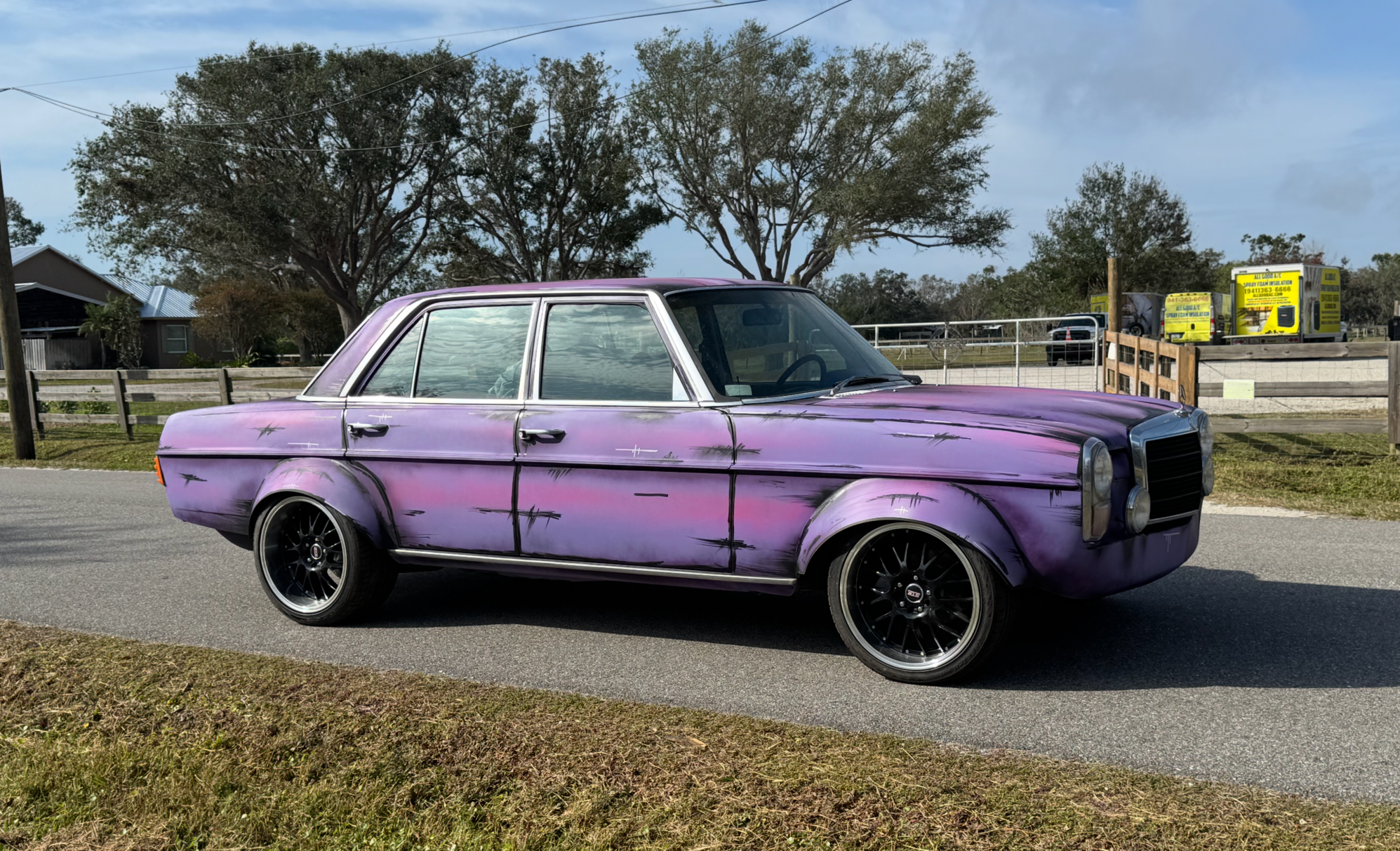

Hi! I'm about to embark on a similar quest - OM606 from a 1993 300TD into a 1975 300D. I have my donor car ready to pull injectors, but it's been sitting there for like 6 months.
How did yours go? Any new updates?
Pic of the 1975 she's going into for fun.
