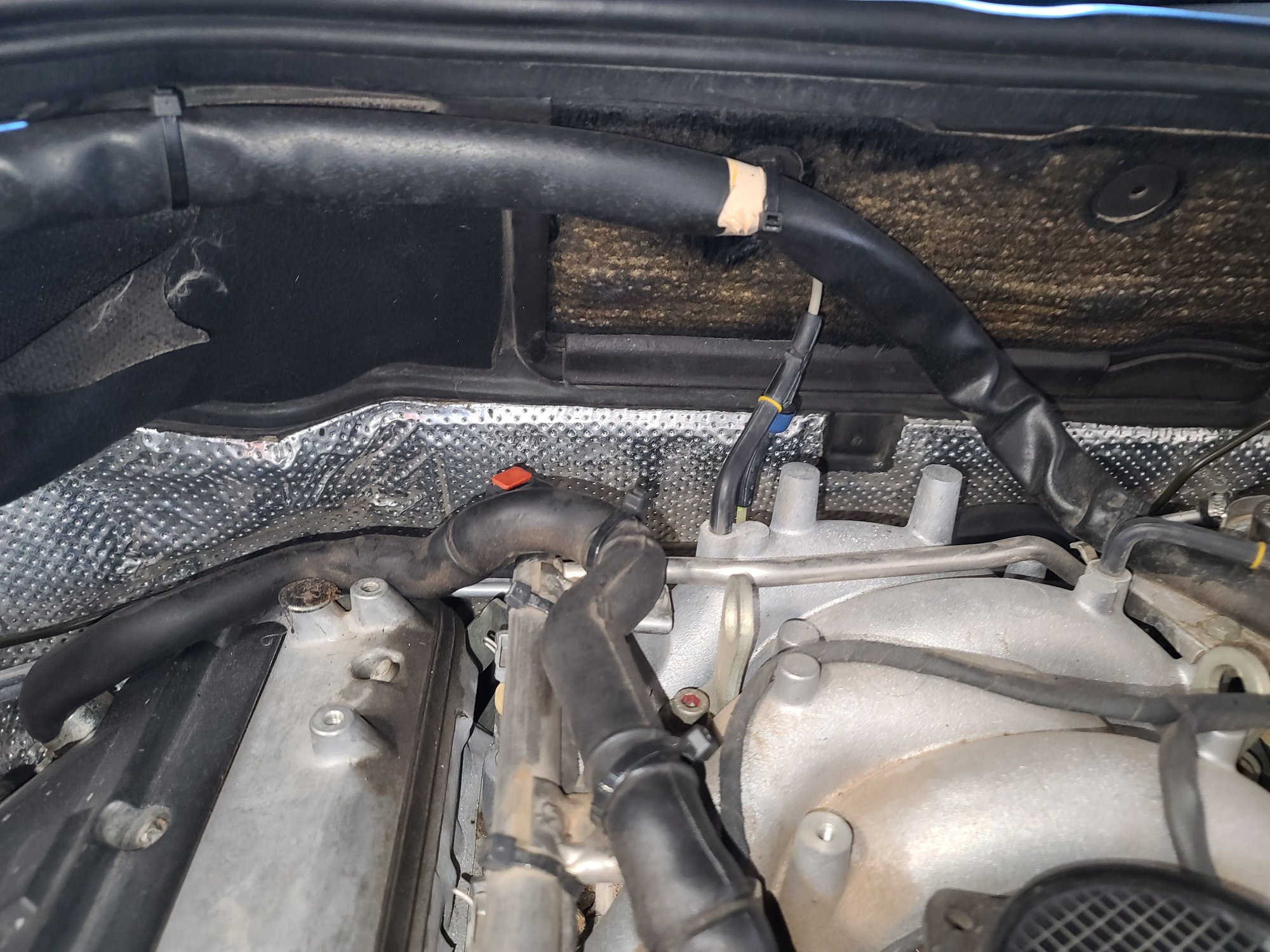

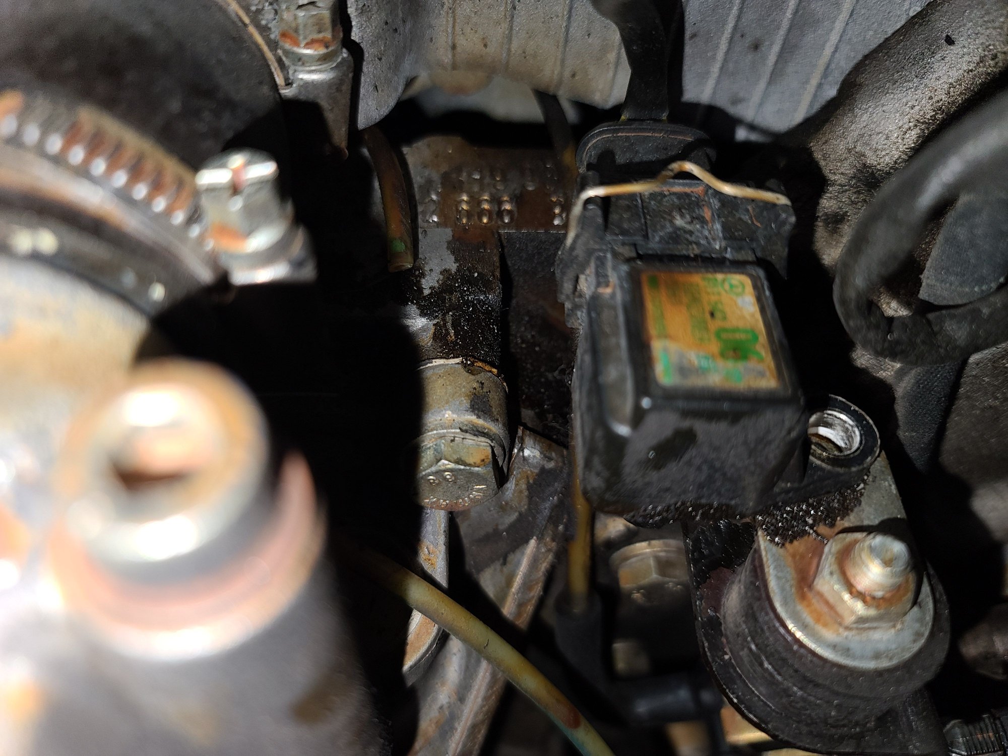

Now, I discovered a leak on the driver's side of the head. So far, no oil in the radiator, nor bubles in the reservoir. SHEESH! When it rains, it pours. I really like this car, so I want to fix this problem. Can anyone suggest how best to proceed?
Any and all suggestions, recommendations, and constructive criticism is greatly appreciated.
