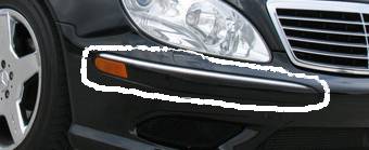

Front bumper side moulding
Does anyone in the good old US of A have the part number of the front bumper side moulding shown below ?? European cars don't have the ones with side lights/repeaters on them
https://mbworld.org/forums/showpost....03&postcount=3
thanks
