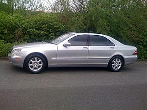

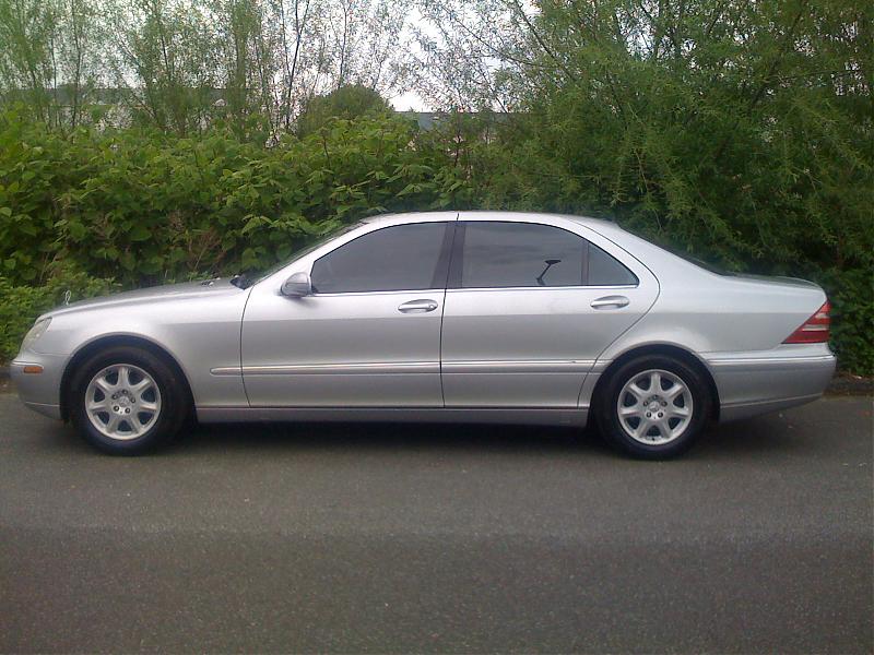

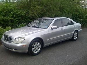

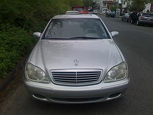

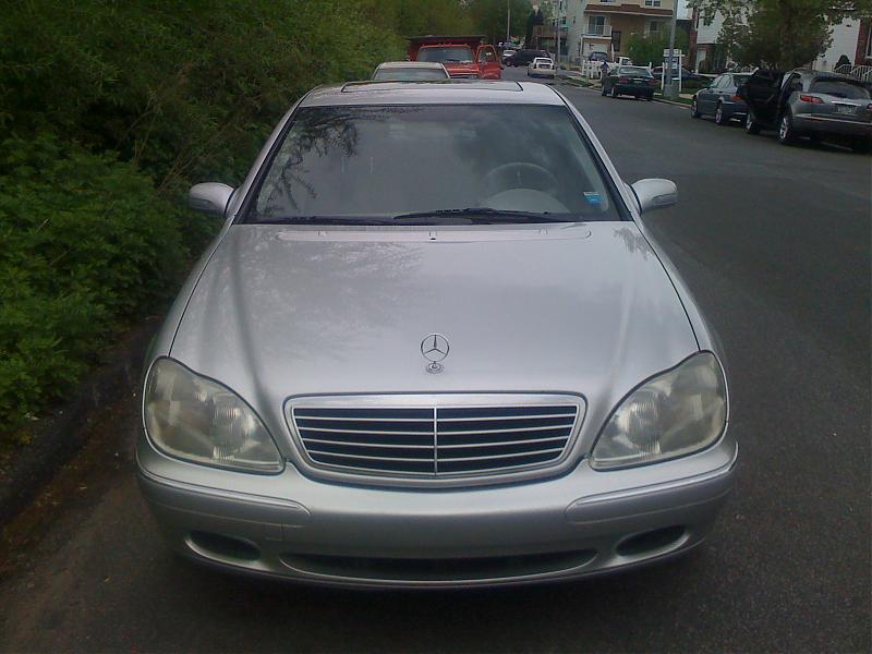

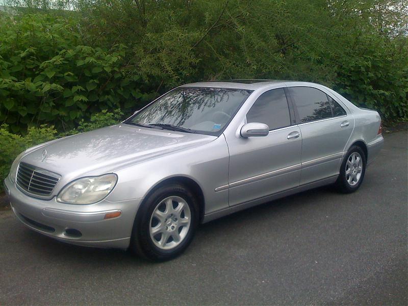

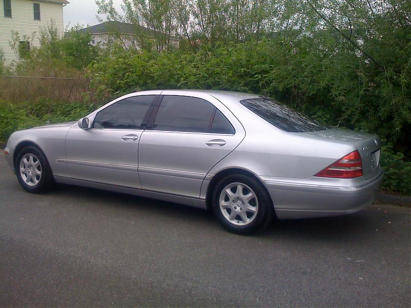

Hi all. Just want to introduce myself. Looks like a great forum. Picked up my 2000 s 430 last week. All stock except for tints. Everything was fine until 2 days ago "Airmatic see Workshop" message came up. The car is leveled fine and the pump does not seem to be working more then it should. When I shut the car off and then start it, the message went away until this morning. I really don't want to take it to the stealeship. Any advise would be appriciated. Attached are some pictures. Sorry for the bad quality used my phone to take them. Thanks
