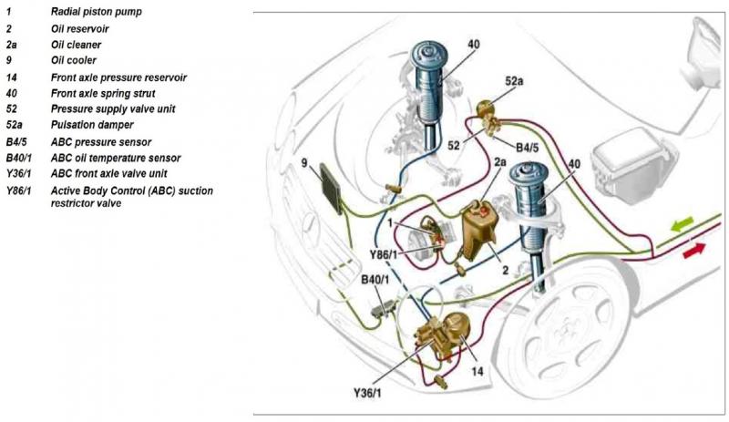

Thanks for everyone's help. Think Im going to give it a try. Does anyone have a idea were this part is located?

2000 CL500 1992 300SE
Look at 52a on the diagram.
