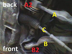

-Please see 2 photos I took from the front-right side suspension on 02 s600 (abc suspension). ( FYI left-front side shows similar cracks )
-Please name/identify (proper name) A, A1, A2, B, B1, B2, C, C1 so I could order the right parts from http://www.germanautoparts.com/Merce...78/S2/23573823 or http://www.partsgeek.com/ymm/2002/mercedes/s600.html or if you know cheaper oem sites. Or if these bushings will be ok if they are not oem.
-Using flash light I could see that A1 is not fully sealed. I could see an opening right under A to A1 ( see white/ lighter spot on the pic ).
-A2 and B2 rubber bushing are torn somewhat.
-B1 and C1 are sealed/ no visible opening
I need to have A1, A2, and B2 replaced. B1 and C1 too maybe/ will these crack later?
What do you think the best way to do it?
1. Should I replace the whole arm ( comes assembled with bushing & ball joint ) or get just the bushing and get them pressed into the end-arm.
2. Nothing is wrong with the metal arm visually, unless due to the mileage, will it crack/ bent ?
3. Under what listing is the shop which could press bushing into the end-arm ?
4. If it is not much to ask ( or maybe ) briefly step by step to replace these will be heaven. I saw the video on ball joint r/r btw.
5. How many average hours pros could do these (left and right side )

Ok , after taking a hard look at my pics, I these are the part names based on the online parts websites.
A. control arm, part # 215 330 07 07, $312.96 , ( mine w/ active body control ) http://www.germanautoparts.com/Mercedes/2002/220.178/S2/3018/23610537
A1. ball joint, ( mounted on steering knucke, do i get this one right? ) part# W0133-1779812, $46.94
http://www.partsgeek.com/catalog/2002/mercedes/s600/suspension/ball_joint.html
A2. control arm bushing, location rear lower, part #W0133-1766815, $36.94 http://www.partsgeek.com/catalog/2002/mercedes/s600/suspension/control_arm_bushing.html
B. control arm ( thrust arm ) Part # 220 330 57 11, $140.49 http://www.germanautoparts.com/Mercedes/2002/220.178/S2/3018/23610537
B1. ??
B2. control arm ( thrust arm bushing kit w/ active body control ), location front lower, part #W0133-1717279 , $46.94 http://www.partsgeek.com/catalog/2002/mercedes/s600/suspension/control_arm_bushing_kit.html
C. ??
C1. ??
This link shows 3 different kind of ball joints, just want to be sure which one is for A1, B1, and C1 http://www.partsgeek.com/catalog/2002/mercedes/s600/suspension/ball_joint.html
Ok, so I actually want to get the parts ( A1, A2, B2 ) and have indy does the both sides for me. I live in west covina area, any of you guys could do these for me, I could travel and wait there, maybe?
