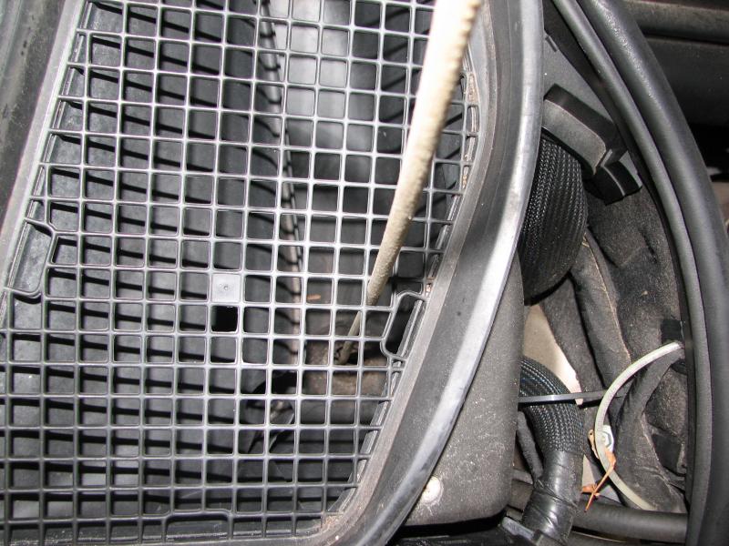

It might be new water damage
Check the drain reservoir under the windshield
Major Electrical issues, help!-7490a3a7-8cd5-4ea1-81c5-926434f42327_zpsrcgflazb.jpg
If theres water in there the reed valve is clogged and that's what caused the problem
