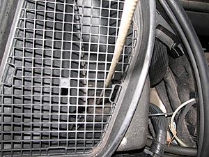

Did it rain while it was sitting ? Sounds like the very common water damage to electronics
Look under the windshield see if there is water still pooled in this plastic reservoir
NO climate control power, NO audio, car running hot when sitting-7490a3a7-8cd5-4ea1-81c5-926434f42327_zpsrcgflazb.jpg
The drain hole at the bottom tends to get plugged up and then the electtical damage starts

If that plastic piece isn't clogged then check under the carpet to see if it is damp. If so, you will need to pull up your carpet to check for water pooling on the floor of the car.
