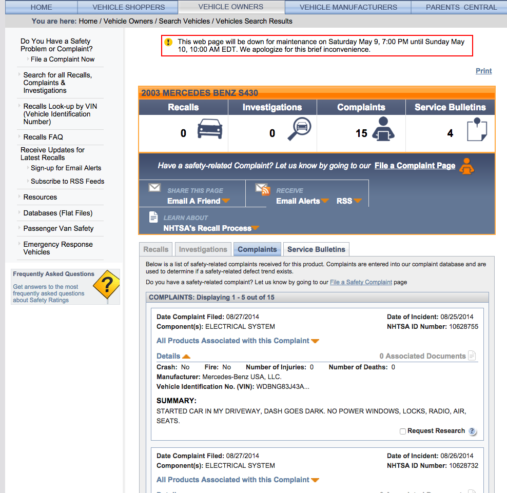

I did create a thread on this forum about this, and at that time the recall warranty was JUST over. Only by a couple of months. Do you think that a MB dealer will replace it right now? If i let the transformer die, would it cause any permanent damage? Or a replacement transformer will bring it back to life?
Actually i may still be in warranty. It was extended to 10 years and began in 2006. So in theory, the recall ends 02/2016.
NHTSA Recall Campaign Number: 06V028000
Component: INTERIOR LIGHTING
Details: ON CERTAIN VEHICLES, THE INSTRUMENT CLUSTER IS EXPERIENCING ELECTRICAL MALFUNCTIONS. THE INSTRUMENT CLUSTER CONTAINS GAUGES AND INDICATORS THAT MUST BE ILLUMINATED WHENEVER THE VEHICLE IS IN OPERATION.
Consequence: DUE TO INADEQUATE ILLUMINATION, THE DRIVER WILL BE UNABLE TO READ THE GAUGES AND INDICATORS, SUCH AS THE SPEEDOMETER, WHICH COULD INCREASE THE RISK OF A CRASH.
Corrective Action: DEALERS WILL REPLACE THE INSTRUMENT CLUSTER MODULES. THE RECALL IS EXPECTED TO BEGIN ON JUNE 10, 2006. OWNERS MAY CONTACT MERCEDES-BENZ AT 1-800-367-6372.
Units Potentially Affected: 36911
Recall Initiated By: ODI
Date added to NHTSA datbase: 02/02/2006
Internal use: 2/2/2006

I just visited the NHTSA website. I see no recalls for my car. I'll make a trip to the dealer tomorrow, as they are closed right now.
Attached Thumbnails Flickering lights on meter-screen-shot-2015-05-09-6.02.44-pm.png

There are no recalls on the instrument cluster. The warranty deal is 10 years from when the car went into service. Don't assume it is through 16. Talk to the service manager at the dealer about the problem and see if they will do anything. Mine was covered because it is a 2006.
